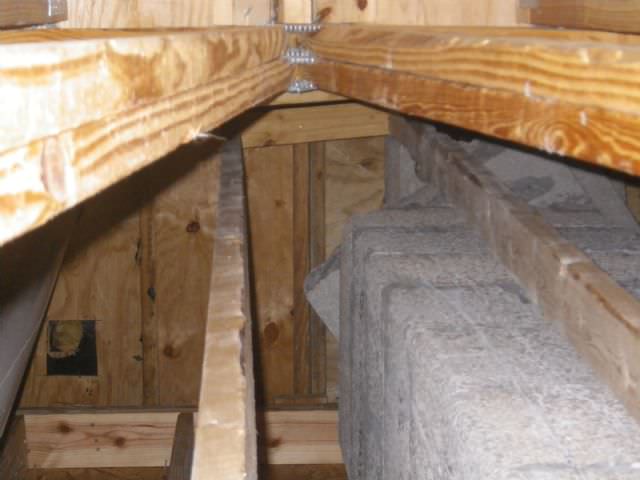

palmettoinspect Posted March 31, 2011 Report Share Posted March 31, 2011 This chimney was from the cottage I inspected today. The top 2-3 blocks were installed twisted and not in line with the rest of the stack. Looking from inside the fireplace the blocks are rounded on the inside so I wouldnââ¬â¢t imagine it matters the way the outside of the blocks are stacked as long as the inside is all in line. Without being able to see from the top of the chimney I donââ¬â¢t know for sure if itââ¬â¢s sealed correctly or not and wanted to get some more opinions. The only label I found installed on the block was the one from this picture. Thanks, Kiel Click to Enlarge 54.44 KB Click to Enlarge 39.12 KB Click to Enlarge 42.52 KB Link to comment Share on other sites More sharing options...
Brandon Whitmore Posted March 31, 2011 Report Share Posted March 31, 2011 Doesn't look right to me. I'd be recommending a level 2. Link to comment Share on other sites More sharing options...
John Kogel Posted March 31, 2011 Report Share Posted March 31, 2011 No way the hole in the first skewed block can be in line with the lower ones, so there's a constriction there. Wood-burning fireplace? That's a real pain for the chimney sweep, eh? Link to comment Share on other sites More sharing options...
palmettoinspect Posted March 31, 2011 Author Report Share Posted March 31, 2011 No way the hole in the first skewed block can be in line with the lower ones, so there's a constriction there. Wood-burning fireplace? That's a real pain for the chimney sweep, eh? Yes itââ¬â¢s a wood burning fireplace. There's a set of gas logs in there now. I agree with you it looks restricted. I wish I couldââ¬â¢ve accessed the cap and looked down it but itââ¬â¢s a pretty steep slate roof and it was raining today. Thanks, Kiel Link to comment Share on other sites More sharing options...
John Kogel Posted March 31, 2011 Report Share Posted March 31, 2011 No way the hole in the first skewed block can be in line with the lower ones, so there's a constriction there. Wood-burning fireplace? That's a real pain for the chimney sweep, eh? Yes itââ¬â¢s a wood burning fireplace. There's a set of gas logs in there now. I agree with you it looks restricted. I wish I couldââ¬â¢ve accessed the cap and looked down it but itââ¬â¢s a pretty steep slate roof and it was raining today. Thanks, Kiel For gas, they could drop in a metal liner, connected to a proper gas fireplace, problem solved. Link to comment Share on other sites More sharing options...
palmettoinspect Posted March 31, 2011 Author Report Share Posted March 31, 2011 I wonder if there's enough room inside the block at the top to do so. Or do you mean take down the block then install the metal chimney? Link to comment Share on other sites More sharing options...

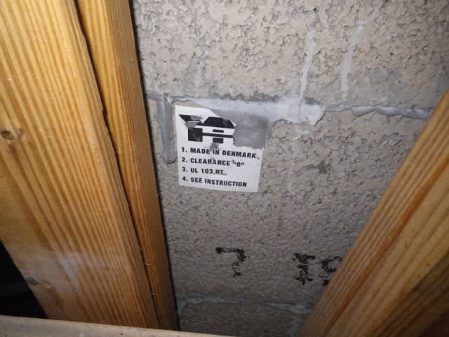

Chad Fabry Posted March 31, 2011 Report Share Posted March 31, 2011 Made in Denmark- If the hole in the block isn't centered in the block, then rotating the block would adjust the chase to allow one to adjust the location of the roof penetration. I have no proof of that but importing block from Denmark must be expensive and I bet they're special. The stains on the block don't look like mortar, they look like an adhesive. The whole thing is probably some system that can be stacked and glued with an intumescent adhesive. The above statement is wild speculation on my part. let me know what's going on after you research it for your client. Link to comment Share on other sites More sharing options...
Chad Fabry Posted March 31, 2011 Report Share Posted March 31, 2011 I didn't feel like waiting. Here's what I found- read the manual Link to comment Share on other sites More sharing options...
Darren Posted March 31, 2011 Report Share Posted March 31, 2011 Unless someone has paperwork stating the block has been properly tested, I would call out the improper clearance to framing members. Link to comment Share on other sites More sharing options...
palmettoinspect Posted April 1, 2011 Author Report Share Posted April 1, 2011 I didn't feel like waiting. Here's what I found- read the manual Chad, Thanks! I read the manual cover to cover. I also checked out their website where there is more info. On the manual it states: Bends can be achieved using purpose made offset blocks. All offset blocks must be fully supported. Itââ¬â¢s also requiring a 1.5â⬠Link to comment Share on other sites More sharing options...
emalernee Posted April 1, 2011 Report Share Posted April 1, 2011 Found this Danish prefab fireplace system on the web, http://www.isokern.net. This could be what you were looking at, as the website does show the ability to offset the blocks. Link to comment Share on other sites More sharing options...
palmettoinspect Posted April 1, 2011 Author Report Share Posted April 1, 2011 Found this Danish prefab fireplace system on the web, http://www.isokern.net. This could be what you were looking at, as the website does show the ability to offset the blocks. After a short look at this site I think this is the system thatââ¬â¢s in this cottage. There is even an office here in Charleston. The sticker from my picture is on a picture from the site. Thanks for all the info guys. Iââ¬â¢m going to contact the Charleston office tomorrow and get this straight. Thanks, Kiel Link to comment Share on other sites More sharing options...

palmettoinspect Posted April 1, 2011 Author Report Share Posted April 1, 2011 I don't doubt the quality of this chimney just the installation. After looking at both the Anki & Isokern chimney systems it looks like the offset blocks are installed wrong. I’m going to get in touch with Isokern tomorrow since they have an office here in town. Hopefully they can take a look at the picture and shed some more light on this. Again thanks for the help and comments. Link to comment Share on other sites More sharing options...

palmettoinspect Posted April 6, 2011 Author Report Share Posted April 6, 2011 Today I got a response back from the architect at Isokern. She stated that this installation looks fine and she even attached a diagram showing offset blocks twisted and their installation. Thanks, Kiel Download Attachment: .pdf"] twisted app[1].pdf 64.51 KBThanks for all the help guys. Kiel Link to comment Share on other sites More sharing options...
