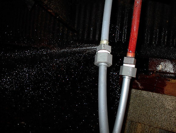

Bill Kibbel Posted March 30, 2011 Report Posted March 30, 2011 Did it have the acetal plastic insert fittings? These have had a majority of the failures. Second is improperly crimped rings. She was asking if its going to fail. Even if it doesn't, when reselling the home, it may be a big issue.
Tim Maxwell Posted March 30, 2011 Report Posted March 30, 2011 The only PB I see still in use at a house is with copper fittings and copper crimp rings. I very rarely see Big Blue that is still in place and if I do it is the 250 psi version, the 160 psi is the one you will rarely see because it has already cracked/leaked and been replaced. I still give the buyer all the info about the past problems and class action but if it's been in place this long it's about as much to worry about as any other pipes.
Greg Booth Posted March 30, 2011 Report Posted March 30, 2011 Although PB pipe failures do occur, the primary leak problems are the acetal (plastic) fittings. If copper fittings & crimp rings have been used (properly installed) there is little concern. When cutting and modifying Quest piping, simply use Pex with brass fittings, onward from the point of interconnect. BUT, be sure to use the Quest X Pex conversion couplings. Although similar in appearance, there is a slight variation in insert size/configuration. There are several types of crimps, but if you are using copper rings, remember that copper color (natural) rings are on the Quest side and black rings are on the Pex side.
ericwlewis Posted April 2, 2011 Report Posted April 2, 2011 In a friends crawlspace, the PB main had split mid line and had been gushing for quite a while. They called me to say their sump pump discharge was leaking and he had patched it with duct tape. The only thing that kept it from spraying everywhere was it being located under the vapor barrier.

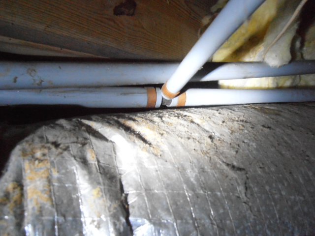

Jim Baird Posted June 23, 2021 Report Posted June 23, 2021 Tubing say quest, but did not see any leaks. 1991 home. Comments?
Marc Posted June 23, 2021 Report Posted June 23, 2021 (edited) I had the same thing on a 93' this past Monday. Buyer lived next door, wanted it for investment purposes and told me the seller had recurrent 'plumbing' problems and wanted me to investigate it. I always write Quest PB. Edited June 23, 2021 by Marc
