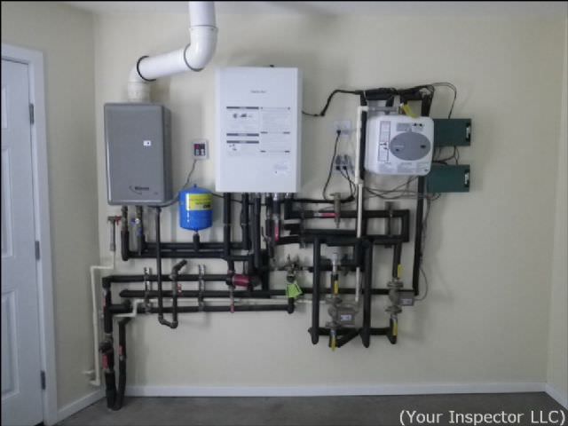

hausdok Posted March 25, 2011 Report Share Posted March 25, 2011 My Dad had a Buderus. It was a wonderful piece of equipment. The Viessmann's that I've seen on high-end homes have all been works of art. Not so much a work of art - a three year old home I did a couple of days ago. The heat source is a Rinnai tankless water heater and it's augmented by a little 4-gallong chinese made on-demand water heater. Built on a slab and heated entirely with in-floor radiant heat. Very confusing configuration. I've looked at lots of these systems but never had one that seemed so cobbled together. I finally referred the guy to Northwest Mechanical. Those guys are rock stars in the radiant heating field. If they endorse it, fine; if not, he'd better take their advice. Click to Enlarge 34.68 KB ONE TEAM - ONE FIGHT!!! Mike Link to comment Share on other sites More sharing options...
