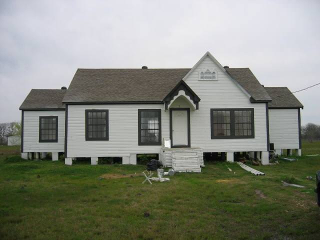

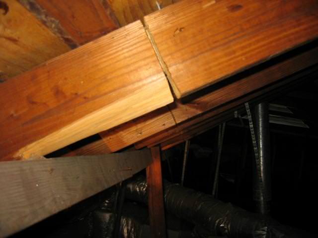

DonTx Posted February 27, 2005 Report Share Posted February 27, 2005 The inspection today was on an old home that had been moved to the country. No one was sure how old the home was. Download Attachment: ChernoskyHome.JPG 41.77 KB From what I could tell, every rafter had been cut in about the same spot. Also, I noted that most of the Gable rafters had been cut about the same height as the rafer cuts. Is it possible that they took the roof off when they moved the home? Download Attachment: rafters2.JPG 51.62 KB Download Attachment: rafters.JPG 37.93 KB Would this be common? I've never seen one done like this before although I've seen the entire roofs removed and rebuilt once the structure was on location. Thoughts? Link to comment Share on other sites More sharing options...
hausdok Posted February 27, 2005 Report Share Posted February 27, 2005 Hi, Yes, it's done sometimes to make it possible to move them without the need to have wires dropped for passage. Here's a site you'll like. Especially the "For Sale" section. Nickel Bros. House Moving ONE TEAM - ONE FIGHT!!! Mike Link to comment Share on other sites More sharing options...
