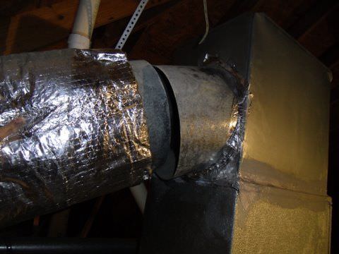

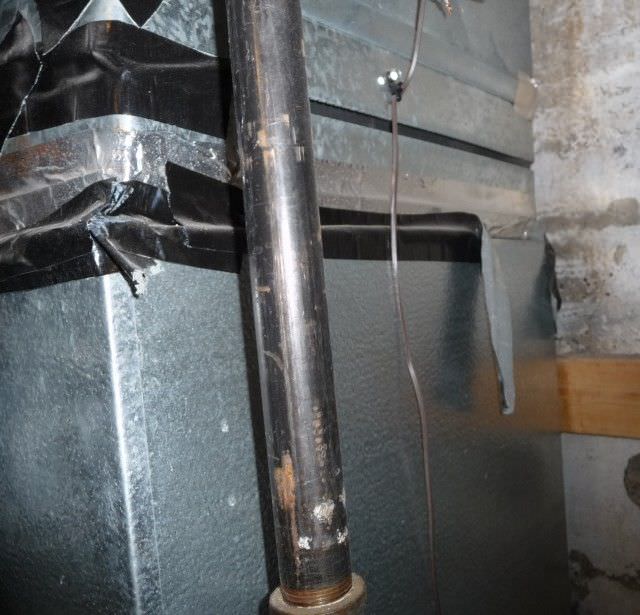

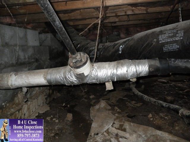

Erby Posted March 5, 2011 Report Posted March 5, 2011 Apparently, some plumbers (handyman homeowner more likely) thinks it is. I sure see plenty of it. Click to Enlarge 60.77 KB Click to Enlarge 62.81 KB Plumbing connections are being held together with duct tape. Duct tape is not generally considered an acceptable plumbing repair. Have a plumber remove the duct tape and fix the piping.

p-squared Posted May 4, 2012 Report Posted May 4, 2012 If duct tape isn't acceptable for plumbing repair, then I have to assume the aluminum foil I found joining a PVC vent stack to a sanitary drain wasn't any good either?
