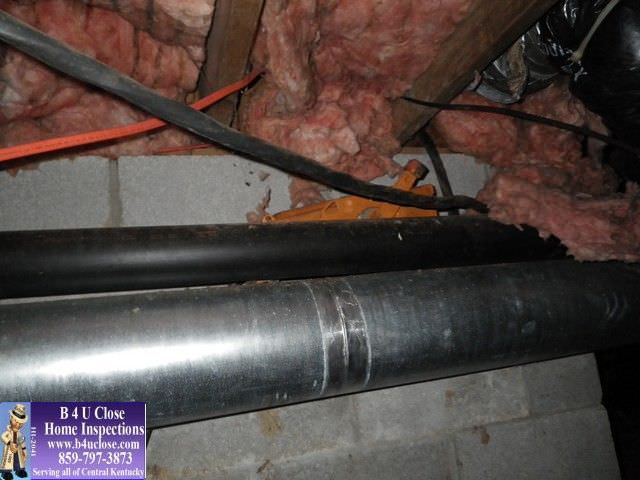

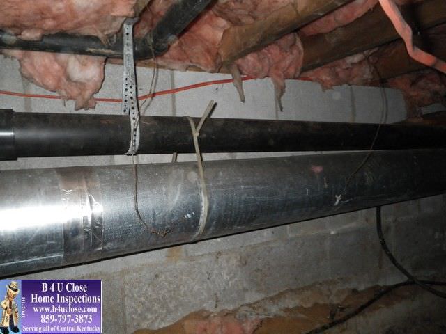

Well, let's see.
1. Install drain piping and properly support from structure above.
2. Install HVAC metal ductwork and support it by cable ties from the drain piping.
3. Lay the electrical disconnect on the metal ductwork trapping it between the drain piping and the foundation wall.
That's good enough, right!

Yes, it was live, supplying power to a baseboard heater.
