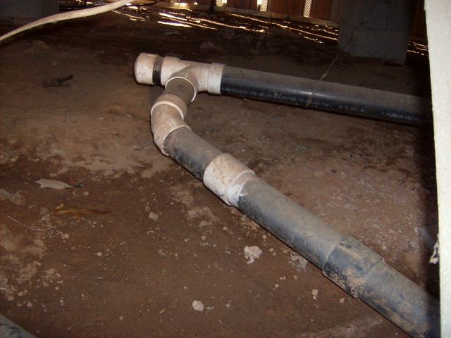

Jim Baird Posted February 18, 2011 Report Share Posted February 18, 2011 Something doesn't look right about this drain assembly under a manufactured home. (The section exiting the lower right corner exits the building) Click to Enlarge 51.05 KB Link to comment Share on other sites More sharing options...

Tom Raymond Posted February 18, 2011 Report Share Posted February 18, 2011 So, did you open the cleanout?[:-dev3] Link to comment Share on other sites More sharing options...
resqman Posted February 18, 2011 Report Share Posted February 18, 2011 Of course you mentioned the improper gluing of ABS and PVC to each other. Link to comment Share on other sites More sharing options...
Jim Baird Posted February 18, 2011 Author Report Share Posted February 18, 2011 So, did you open the cleanout?[:-dev3] Tom, best I can tell that ain't no cleanout, it's a cap. Link to comment Share on other sites More sharing options...
Jeff Remas Posted February 20, 2011 Report Share Posted February 20, 2011 That is just stupid no matter how you look at it. Sanitary Tee on its side, change of direction more than 45 deg without a clean out. ABS PVC glue issues, primer issues, complete nonsense. Link to comment Share on other sites More sharing options...

Jerry Lozier Posted February 21, 2011 Report Share Posted February 21, 2011 That is just stupid no matter how you look at it. Sanitary Tee on its side, change of direction more than 45 deg without a clean out. ABS PVC glue issues, primer issues, complete nonsense. What Jeff said, also slope to drain? Link to comment Share on other sites More sharing options...
