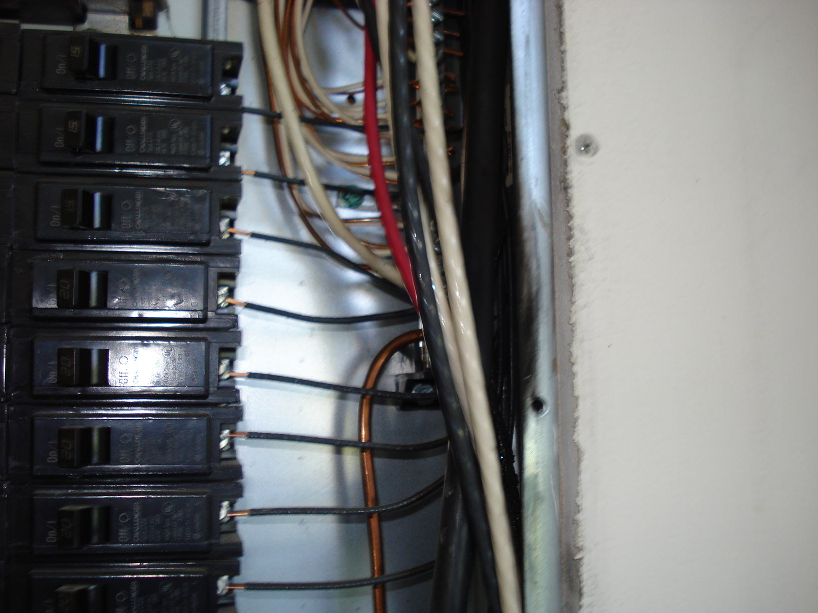

Bain Posted January 22, 2011 Report Posted January 22, 2011 That's awful, Darren. I'm sorry. The screw hitting a wire thing has happened to me twice, both times when I was removing the deadfront. Both times, I sorta froze while my feeble mind decided what to do next. One of the times, smoke started streaming out of the panel. I removed the remaining screws, thinking to myself, "Okay, so you're going to trip the main, race into the kitchen, get a cup of water, and douse the panel (Of course, you have to avoid the SE cables so something really nasty doesn't happen). " I actually wound up blowing on the smoking insulation, and it stopped smoldering. Of course, the entire remainder of the time I was in the house, and even into the night, I kept thinking it could still be smoldering and could erupt into a blaze at any moment. It didn't . . . thankfully. Now, though, every single time I pull off a deadfront, I worry that the episode will repeat itself.

Bain Posted January 22, 2011 Report Posted January 22, 2011 When I suspect those pointed screws, I do not re-install the cover after the inspection. I notify the seller if he's on the premises and put an explanation in the report. Marc I would never ever ever leave the cover off if it was on when I arrived. Way to many bad thoughts come to mind. What if the home owner or kids were killed, due to their ignorance of the dangers? What if there were a fire and it was not contained because the cover was off? What if the pet tweety bird got zapped? I have panel screws in my tool box. Yep, leaving the cover off is just plain silly. Here's a lousy photo of the panel I described above. If you look closely, you can see the melted insulation on the right. Download Attachment: DSC00537.jpg 812.84 KB
