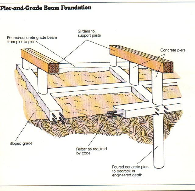

hausdok Posted January 16, 2011 Report Share Posted January 16, 2011 Seems a little steep. They could probably lift that, move it 150 ft. put down a grade beam and pier foundation and then put it on it's new foundation for less than $250K. ONE TEAM - ONE FIGHT!!! Mike Link to comment Share on other sites More sharing options...

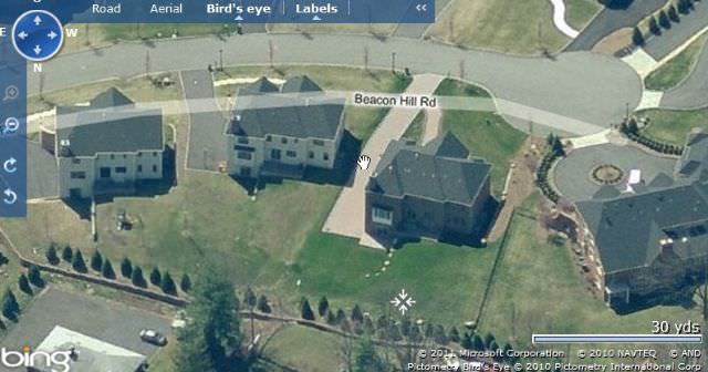

Bill Kibbel Posted January 17, 2011 Report Share Posted January 17, 2011 David, for more than the last decade, most homes built here have walk-out basements at the side or rear, so much of the foundation is above grade in those areas. Footings not deep enough below the "daylight" basement foundations has come up in some litigation work I've done. Link to comment Share on other sites More sharing options...
Bill Kibbel Posted January 17, 2011 Report Share Posted January 17, 2011 See: Click to Enlarge 46.55 KB It's the development where the house in the article sits. Link to comment Share on other sites More sharing options...
hausdok Posted January 17, 2011 Report Share Posted January 17, 2011 The house is in full-basement land. It probably has or was intended to eventually have a bar, gym and theatre. I don' tknow what they cost there; but I watched them raise a 100 year old Queen Anne here that was moving a little, put a deep pier and grade beam foundation below a 10 ft. basement below it and then set her back down on her nice new foundation; all for less than $125K. ONE TEAM - ONE FIGHT!!! Mike Click to Enlarge 74.22 KB Link to comment Share on other sites More sharing options...
