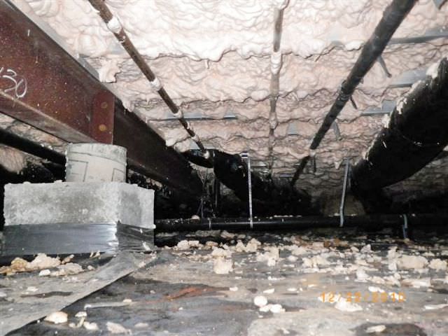

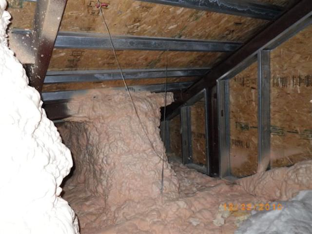

Robert Jones Posted December 22, 2010 Report Share Posted December 22, 2010 This home was built in 1995. All metal framing from floor through attic. Is there a technical name for this type of attic framing? Still considered a truss? I was surprised to run into the spray in insulation as well. I am including a pic of the crawl space cavity as well. BTW, that isn't UFFI is it? Click to Enlarge 64.81 KB Click to Enlarge 52.49 KB Click to Enlarge 66.76 KB Link to comment Share on other sites More sharing options...
Terence McCann Posted December 22, 2010 Report Share Posted December 22, 2010 It's not a truss system Robert. I must admit though the only place I've seen metal studs and such was in commercial build-outs - like in office hi-rise towers. Link to comment Share on other sites More sharing options...
AHI in AR Posted December 23, 2010 Report Share Posted December 23, 2010 Steel framed homes around here are extremely rare. I've seen one in 11 years, but it was built right around 1995. I can say that the horizontal steel roof members supported by the rafters are called purlins. Link to comment Share on other sites More sharing options...
Marc Posted December 23, 2010 Report Share Posted December 23, 2010 I agree with Terry. Gusset plates are what gives off a truss. I wonder if those purlins are upside down. There's greater forces pushing down than up. Noticed that the long side of the decking panels and the purlins are still at right angles to each other, which is important. Rated sheathing is rated only along the long edge. Looks like expanding XPS foam. I'd call it steel framed. I inspected one for my niece a few years ago. Marc Link to comment Share on other sites More sharing options...
hausdok Posted December 23, 2010 Report Share Posted December 23, 2010 In JLC and NAHB pubs when they refer to it they commonly term it "Light Gauge Steel Framing" tbut the codes refer to it as "Cold Formed Steel Framing" There are whole sections on it in the code. You want to look at R505, R603 and R804. Use these links to take you to the Seattle building code chapters. http://ecodes.biz/ecodes_support/free_r ... Floors.pdf http://ecodes.biz/ecodes_support/free_r ... uction.pdf http://ecodes.biz/ecodes_support/free_r ... uction.pdf ONE TEAM - ONE FIGHT!!! Mike Link to comment Share on other sites More sharing options...
kurt Posted December 23, 2010 Report Share Posted December 23, 2010 Cold formed. The primary structure is cold rolled steel channel; the light gauge stuff is for purlins, partitions, and interior framing. That's what it looks like in the pic, anyway. It looks like an interesting house. I've only ever seen one. How was this one? Link to comment Share on other sites More sharing options...

esch Posted December 23, 2010 Report Share Posted December 23, 2010 Did you see any red iron or was it all steel? Matt Link to comment Share on other sites More sharing options...

Robert Jones Posted December 23, 2010 Author Report Share Posted December 23, 2010 Thanks for the replies and information. The home was really sound. Extremely well insulated, even the foundation walls had insulation. The only real item I could tell needed some improvement was the attic ventilation. The roof had a continuous ridge vent but no soffit venting. Some of the sheathing was showing fungal growth, which must have been an ongoing issue as there were two attic fans installed. Matt there was red iron present. Link to comment Share on other sites More sharing options...

Douglas Hansen Posted December 24, 2010 Report Share Posted December 24, 2010 Shouldn't that foam be behind a "thermal" (fire) barrier, such as gypsum board? Whether icynene or UFFI, I thought it was supposed to be covered in completed construction, and that you should never see it exposed like this. Douglas Hansen Link to comment Share on other sites More sharing options...
Rocon Posted December 24, 2010 Report Share Posted December 24, 2010 Shouldn't that foam be behind a "thermal" (fire) barrier, such as gypsum board? Whether icynene or UFFI, I thought it was supposed to be covered in completed construction, and that you should never see it exposed like this. Douglas Hansen It is used on roofs all the time. Of course there are different types which have different flame spread rates. The attic is very simmilar to a mock up I saw at the International builders show last year. Link to comment Share on other sites More sharing options...
hausdok Posted December 24, 2010 Report Share Posted December 24, 2010 Shouldn't that foam be behind a "thermal" (fire) barrier, such as gypsum board? Whether icynene or UFFI, I thought it was supposed to be covered in completed construction, and that you should never see it exposed like this. Douglas Hansen Hi Douglas, I think the answer to your question is, "That depends." 1. On whether it is an attic in the sense of a storage attic or an attic in the sense of a utility space 2. On the flame-spread and smoke characteristics of the material used. R316.4 Thermal Barrier. Unless otherwise allowed in Section R316.5 or R316.6, foam plastic shall be separated from the interior of a building by an approved thermal barrier of minimum 1/2 inch (12.mm) gypsum wallboard or an approved finish material equivalent to a thermal barrier material that will limit the average temperature rise of the unexposed surface to no more than 250°F :(139°C) after 15 minutes of fire exposure complying with the ASTM E 119 or UL 263 standard time temperature curve. The thermal barrier shall be installed in such a manner that i;t will remain in place for 15 minutes based on NFPA 286 with the acceptance criteria of Section R302.9.4, FM 4880, UL 1040 or UL 1715. R316.5.3 Attics. The thermal barrier specified in Section R316.4 is not required where all of the following apply: 1. Attic access is required by Section R807.1. 2. The space is entered only for the purposes of repairs or maintenance. 3. The foam plastic insulation is protected against ignition using one of the following ignition barrier materials: 3.1. 1-1/2 inch thick (38 mm) mineral fiber insulation;3.2. 1/2-inch-thick (6.4 mm) wood structural panels; 3.3. 3/8-inch (9.5 mm) particleboard; 3.4 . 1/4-inch (6.4 mm) hardboard. 3.5. 3/8-inch (9.5 mm) gypsum board; or 3.6. Corrosion-resistant steel having a base metal thickness of 0.016 inch (0.406 mm). The above ignition barrier is not required where the foam plastic insulation has been tested in accordance with Section R316.6. R316.6 Specific Approval. Foam plastic not meeting the requirements of Sections R316.3 through R316.5 shall be specifically approved on the bases of one of the following approved tests: NFPA 286 with the acceptance criteria of Section R302.9.4, FM4880, UL 723, UL 1040 or UL 1715, or fire tests related to actual end-use configurations. The specific approval shall be based on the actual end use configuration and shall be performed on the finished foam plastic assembly in the maximum thickness intended for use. Assemblies tested shall include seams, joints and other typical details used in the installation of the assembly and shall be tested int he manner intended for use. I think that the SPF manufacturers have probably figured out by now that builders won't want to use the product if they have to install another barrier over the top of it; so they're making products that can meet the exception in 316.6. ONE TEAM - ONE FIGHT!!! Mike Link to comment Share on other sites More sharing options...
