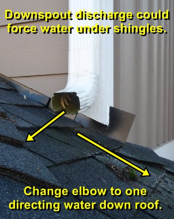

Darren Posted December 17, 2010 Report Share Posted December 17, 2010 I tell my clients something along these lines: Discharge from upper sections of gutters should run into the lower gutters via downspout extensions or terminate directly to the ground rather than discharging onto the roofing materials. Link to comment Share on other sites More sharing options...
Terence McCann Posted December 17, 2010 Report Share Posted December 17, 2010 I tell my clients something along these lines: Discharge from upper sections of gutters should run into the lower gutters via downspout extensions or terminate directly to the ground rather than discharging onto the roofing materials. Me too. Link to comment Share on other sites More sharing options...
Chad Fabry Posted December 17, 2010 Report Share Posted December 17, 2010 The manufacturer never intended for the shingles to handle this volume of water, IMHO. Are you saying that manufacturers don't intend for shingles to be installed in valleys? The quantity of water is no different. The valley only carries the water from the triangles directly above it- there's no impact considerations either and the water being discharged from a smooth vertical pipe is moving much faster than water running down a sloped irregular surface. The area below a roof directed downspout may be subjected to many times the volume of water than a valley would be subjected to ie a 20x 40 roof could be discharged at a single point. At any rate, valleys wear out much faster than the adjacent fields. Link to comment Share on other sites More sharing options...

Terence McCann Posted December 17, 2010 Report Share Posted December 17, 2010 You can't get any clearer evidence than Darren's picture. The fact is indisputable. Now, if the excess water caused excessive growth of moss, lichen, algae which destroyed the shingles in that area so be it. Whatever the case it is a good idea to inform the client to extend downspouts to the lower gutter. I still think it's bad form to expel a lot of run off on a small area of shingles (a little Dormer notwithstanding) but God forbid we tamper with the aesthetics of the 2,200 sq ft McMansion. What will the neighbors say Harry? Link to comment Share on other sites More sharing options...
Bain Posted December 17, 2010 Report Share Posted December 17, 2010 You can't get any clearer evidence than Darren's picture. The fact is indisputable. Now, if the excess water caused excessive growth of moss, lichen, algae which destroyed the shingles in that area so be it. Whatever the case it is a good idea to inform the client to extend downspouts to the lower gutter. I still think it's bad form to expel a lot of run off on a small area of shingles (a little Dormer notwithstanding) but God forbid we tamper with the aesthetics of the 2,200 sq ft McMansion. What will the neighbors say Harry? Water causes erosion. The Grand Canyon is all the proof one needs of that, though Darren's photo makes a pretty good case, as well. But the solution in Darren's photo is to extend the leader along the tops of the shingles so it empties into a lower gutter. That would be ugly. It would trap leaves. And the lower gutter might be overwhelmed and allow water to flow back into the soffit. I think this is one of those things that, while not ideal, is just the way it's gotta be. Link to comment Share on other sites More sharing options...

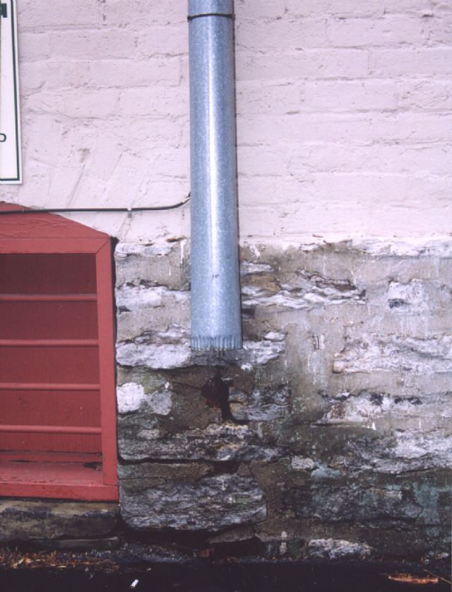

Terence McCann Posted December 18, 2010 Report Share Posted December 18, 2010 What are we looking at John? Link to comment Share on other sites More sharing options...
Bain Posted December 18, 2010 Report Share Posted December 18, 2010 What are we looking at John? A gutter downspout/leader that's missing its extension. The water flowing down the foundation wall destroyed the mortar joints. Like I said previously, lots of houses in my area have gutter systems similar to the one in Brandon's photo, and I don't think there's much that can be done about them without gunking up a house's appearance. But to say that one shingle that has significantly more water trailing down it will last as long as a shingle under normal circumstances simply isn't logical. Link to comment Share on other sites More sharing options...
Terence McCann Posted December 18, 2010 Report Share Posted December 18, 2010 I have never, in my life, seen 6" duct used as a downspout. The red thing next to it looks like a built in bookshelf. Link to comment Share on other sites More sharing options...
Bain Posted December 18, 2010 Report Share Posted December 18, 2010 I have never, in my life, seen 6" duct used as a downspout. The red thing next to it looks like a built in bookshelf. The photo was taken at a 10K square foot commercial building that was really tall, and which had box gutters that were junk. The bookshelf is actually a boarded-over basement window with bars in front of it. Link to comment Share on other sites More sharing options...
