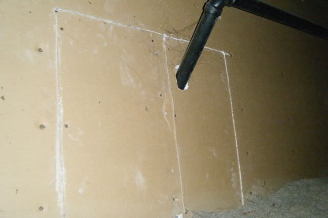

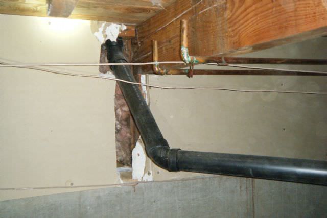

Brandon Whitmore Posted December 10, 2010 Author Report Share Posted December 10, 2010 Here's some pictures of the penetrations. Click to Enlarge 33.76 KB Click to Enlarge 25.36 KB Click to Enlarge 30.44 KB Link to comment Share on other sites More sharing options...

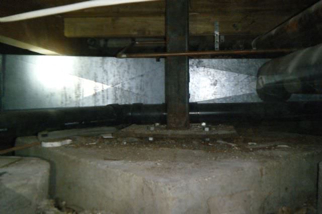

Brandon Whitmore Posted December 10, 2010 Author Report Share Posted December 10, 2010 Here's another issue I ran into. This steel support column's flange/ plate? didn't quite make it to the pad. The contractor figured out an ingenious way to address this issue....... I'm sure it's just as sound this way. Click to Enlarge 43.21 KB Click to Enlarge 35.78 KB Link to comment Share on other sites More sharing options...

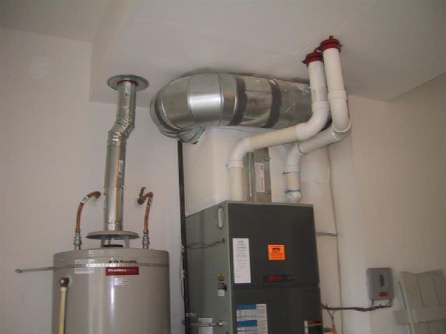

hausdok Posted December 10, 2010 Report Share Posted December 10, 2010 Hi, Those penetrations should have had collars like these attached. http://www.astroflame.com/intumescent_pipe_collars.html ONE TEAM - ONE FIGHT!!! Mike Link to comment Share on other sites More sharing options...
Brandon Whitmore Posted December 10, 2010 Author Report Share Posted December 10, 2010 Thanks Mike, I don't think I've ever seen anything like it before. Link to comment Share on other sites More sharing options...
Jim Katen Posted December 10, 2010 Report Share Posted December 10, 2010 Thanks Mike, I don't think I've ever seen anything like it before. Arbor used them in a few houses up in the Bethany area. Click to Enlarge 27.32 KB Click to Enlarge 20.42 KB Of course, that's not a fire-rated ceiling assembly. I'm still unable to find anything that allows plastic pipe to run through a fire rated wall, even with the intumescent collars. It's probably a local AHJ call. Whether or not the walls in your pictures were constructed properly is moot at this point. They've been hacked up enough to merit serious repair. - Jim Katen, Oregon Link to comment Share on other sites More sharing options...
hausdok Posted December 10, 2010 Report Share Posted December 10, 2010 Neither had I until I'd taken that course this week. It's an intumescent collar. When the heat gets near it and starts to melt the ABS, it expands and completely collapses the melting pipe and plugs the hole. ONE TEAM - ONE FIGHT!!! Mike Link to comment Share on other sites More sharing options...
Marc Posted December 10, 2010 Report Share Posted December 10, 2010 Here's some pictures of the penetrations. Click to Enlarge 33.76 KB Click to Enlarge 25.36 KB Click to Enlarge 30.44 KB I've never seen joists penetrate a firewall. They're not supposed to. Makes me wonder if this construction was really installed to mitigate sound transmission between the two adjacent office condos. Marc Link to comment Share on other sites More sharing options...
hausdok Posted December 10, 2010 Report Share Posted December 10, 2010 It's not a joist - it's a beam. That's a plank and beam system. Still, you're right, don't recall seeing them penetrate a fire wall before. ONE TEAM -ONE FIGHT!!! Mike Link to comment Share on other sites More sharing options...
Erby Posted December 10, 2010 Report Share Posted December 10, 2010 Here's another issue I ran into. This steel support column's flange/ plate? didn't quite make it to the pad. The contractor figured out an ingenious way to address this issue....... I'm sure it's just as sound this way. Click to Enlarge 43.21 KB Click to Enlarge 35.78 KB It's a leveling method (to make the column plumb) Look at your street light and traffic light bases. Same theory. Allows for fine adjustment to ensure the column is plumb. Link to comment Share on other sites More sharing options...
Tom Raymond Posted December 12, 2010 Report Share Posted December 12, 2010 Yes and it works fine there, but a column that is supporting structure needs to be grouted when it is placed like that. At least they did here in the 90's. Link to comment Share on other sites More sharing options...
Brandon Whitmore Posted December 12, 2010 Author Report Share Posted December 12, 2010 Yes and it works fine there, but a column that is supporting structure needs to be grouted when it is placed like that. At least they did here in the 90's. I figured as much, but don't run into steel column's very often. Nothing like pouring a large pad, using a large steel plate, and then relying on a few threads for compressive strength. Link to comment Share on other sites More sharing options...
