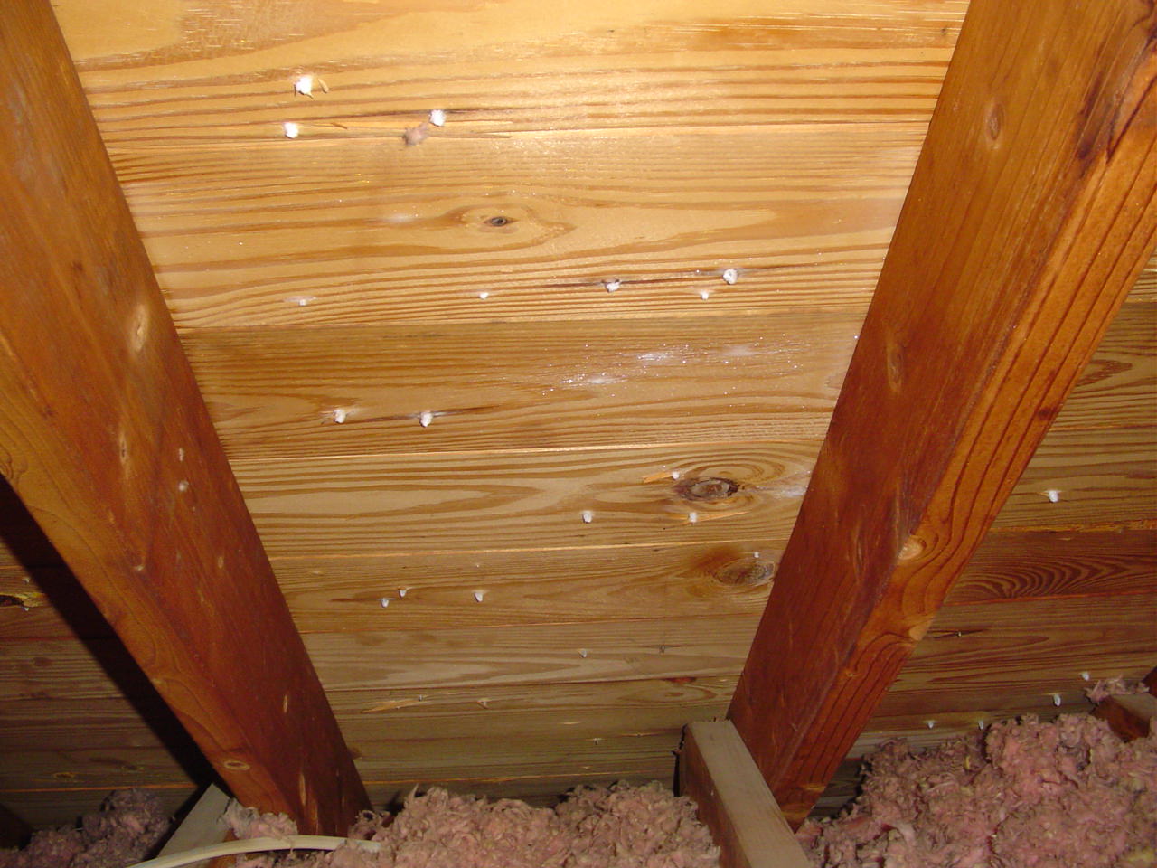

No real question, here, but check out the roof decking of a house I was in today. That's actually ice coating the tips of the roofing nails. The only vents were the gable louvers, which clearly weren't creating much of a cross current.

About the decking. Those are some clean looking boards that must be fairly old. There isn't any staining on the rafters either, and no drip marks on the ceiling joists.
I've been a lot of attics lately covered with black and slimey sheathing covered with mold or whatever it is. Makes me want to hold my breath.

You see that all of the time in MN, usually with small black stains around the nail penetration. From the lack of the stains I would say that either this is the first winter this house has been through or something with the ventilation / vapor barrier has changed dramatically recently.

I see that daily this time of year. Like Matt, I base my interpretations on surrounding conditions; w/as clean as that picture looks, I'd probably point it out to my customer as an interesting aside, not a particular defect.
I got a picture in my camera waiting to be downloaded that will interest you; taken yesterday in 2 degree weather. The sheathing is black & covered in a sheet of ice; that gets a comment in the report.

The reason the wood's so clean is that the temperature here yesterday was about five degrees, which we don't see too terribly often. Today's in the mid-thirties and it feels almost like Spring.
