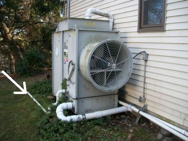

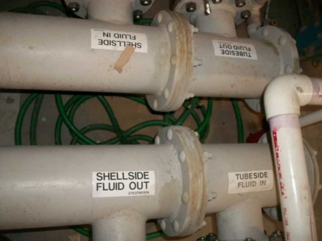

Neal Lewis Posted December 3, 2010 Report Share Posted December 3, 2010 OK, I think what we have here installed at a single family house is an exterior chiller/heat pump and some type heat exchange unit on the interior. There are hydro-air air handlers to heat the house.There's also a hot water boiler for backup heat. Help me out with this one. Click to Enlarge 26.67 KB Click to Enlarge 41.47 KB Click to Enlarge 62.16 KB Link to comment Share on other sites More sharing options...

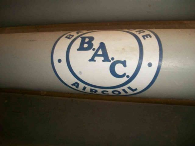

Bill Kibbel Posted December 3, 2010 Report Share Posted December 3, 2010 From the 2 pictures, it sure looks like the components of an evaporative condenser for cooling. I don't think there's any heat pump involved. Heating is supplied by the boiler. I've seen many at commercial and industrial building inspections, but only one at a "residence". It was a very large historic house museum with additions for offices. What size was this house? I thought evaporative condenser cooling systems were 10 tons or larger. B. A. C. is probably Baltimore Air Co., which I think is a big manufacturer of evaporative cooling equipment. Link to comment Share on other sites More sharing options...

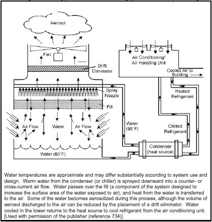

Bill Kibbel Posted December 3, 2010 Report Share Posted December 3, 2010 This might help describe the system: Click to Enlarge 30.47 KB I've got lotsa printed stuff on evaporative cooling I could send you, but Terry could probably give you a condensed course that's probably better than what I have. Were there any water treatment systems? Any maintenance records? Link to comment Share on other sites More sharing options...
Terence McCann Posted December 3, 2010 Report Share Posted December 3, 2010 How many square feet is that house? A lot more pictures would help but I'll try to help with what I see. As Bill said BAC stands for Baltimore Aircoil Company http://www.baltimoreaircoil.com/english/ The outside unit is just a cooling tower. If it were an evaporative condenser you would see four pipes going to it. From BAC: Principle of Operation The vapor to be condensed is circulated through a condensing coil, which is continually wetted on the outside by a recirculating water system. Air is pulled over the coil, causing a small portion of the recirculating water to evaporate. The evaporation removes heat from the vapor in the coil, causing it to condense. http://www.baltimoreaircoil.com/english ... condensers A very basic description would be the condenser coil from an air conditioner sitting inside the cooling tower. Water then is pumped over the condenser coil - using water instead of air to condense. The second picture is a heat exchanger. It maybe a shell&tube or a tube&tube but I can't see where all the piping goes to make a determination on type or purpose. Did you see a chiller? You say there is a boiler, were you able to trace this piping? How many AHUs were there? You say there was water piping going to them, were you able to trace it out? It could be a few different systems but I would need more information to make a call. More pictures would help too. Link to comment Share on other sites More sharing options...

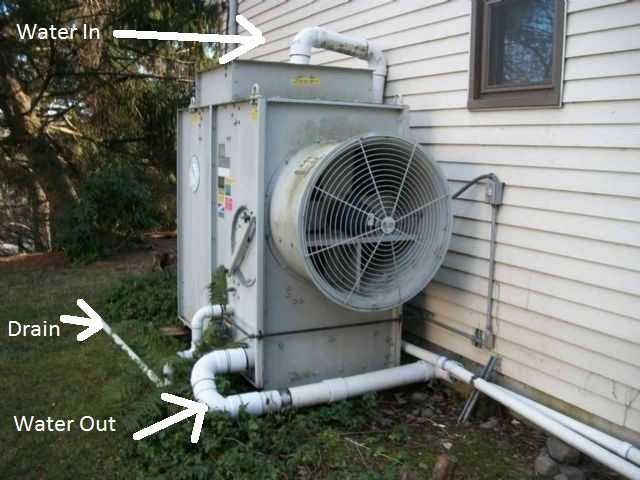

Neal Lewis Posted December 3, 2010 Author Report Share Posted December 3, 2010 Terry, yes four pipes going to the outside unit to the inteior coil exchanger(big tube thing, which was warm) Bill, the boiler was cold until I fired it up for the baseboard zone in the basement. See if this pic will help. Click to Enlarge 37.73 KB Link to comment Share on other sites More sharing options...

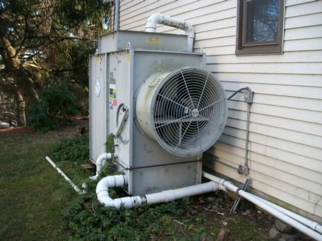

Terence McCann Posted December 3, 2010 Report Share Posted December 3, 2010 Were did this line go Neal? It looks like a drain. Click to Enlarge 63 KB Link to comment Share on other sites More sharing options...
Neal Lewis Posted December 3, 2010 Author Report Share Posted December 3, 2010 Terry, I found out that the pipe is to drain down the cooling tower for the winter. This unit is capable of 14 tons, and probably only needs 4-5 for the house. There are water source heat pumps/compressors in each of the air handlers that work in conjunction with the High K heat exchanger (the big tube) to heat the house. The hot water boiler is also piped into it for emergency backup. Link to comment Share on other sites More sharing options...
Terence McCann Posted December 3, 2010 Report Share Posted December 3, 2010 That's what I thought Neal. There are only two lines going to the cooling tower then - it's a cooling tower only. Do you have any pictures of the air handlers Neal? How many air handlers were there? Was the water piping going to the AHUs? It's almost sounds like you have a water source heat pump installation but I can't be sure. In the basement, by the boiler, did you see a chiller (compressor, piping etc)? The owner of the home must have owned a HVAC distributorship because that system is really overkill. Click to Enlarge 65.36 KB Link to comment Share on other sites More sharing options...
