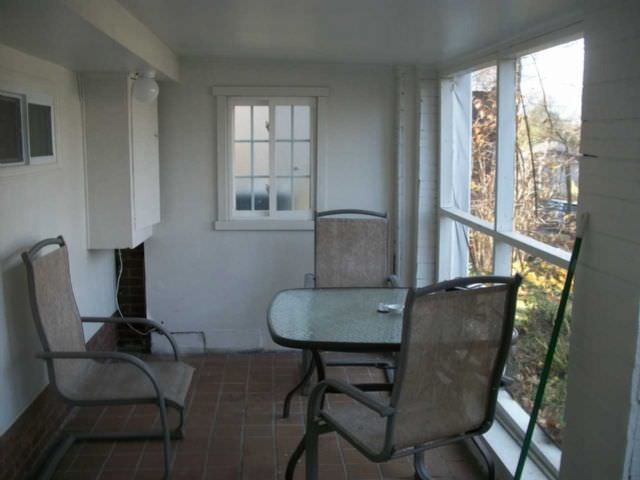

Neal Lewis Posted November 20, 2010 Report Share Posted November 20, 2010 There is a new circuit breaker panel box in this screen porch in the enclosed cabinet at the rear left, adjacent to the basement wall. There is a window next to the panel box, but the rest of the outside walls are screened only. Is a panel box rated for exterior use required here? Click to Enlarge 37.27 KB Link to comment Share on other sites More sharing options...
Marc Posted November 20, 2010 Report Share Posted November 20, 2010 There is a new circuit breaker panel box in this screen porch in the enclosed cabinet at the rear left, adjacent to the basement wall. There is a window next to the panel box, but the rest of the outside walls are screened only. Is a panel box rated for exterior use required here? Click to Enlarge 37.27 KB My guess is 'no'. It's a damp location because of the openings but not a wet location because rain will not contact it. Only enclosures in wet location are required to be weatherproof. Marc Link to comment Share on other sites More sharing options...
Jim Katen Posted November 20, 2010 Report Share Posted November 20, 2010 There is a new circuit breaker panel box in this screen porch in the enclosed cabinet at the rear left, adjacent to the basement wall. There is a window next to the panel box, but the rest of the outside walls are screened only. Is a panel box rated for exterior use required here? No. A regular Type 1 enclosure is probably fine. It won't be exposed to liquids or splashing, or rain, snow, or sleet. Of course, the panel shouldn't be in that cabinet in the first place. Link to comment Share on other sites More sharing options...
