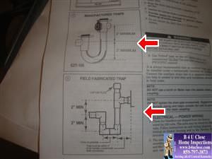

Greg Booth Posted November 19, 2010 Report Share Posted November 19, 2010 Is the evaporator drain trapped? You indicated that the drain was working when you poured water into it-but is it properly trapped? Without the trap, water can pond in the pan and lead to carry-off of moisture. Link to comment Share on other sites More sharing options...
Jim Katen Posted November 19, 2010 Report Share Posted November 19, 2010 It's the original motor that came with the unit...I always use the same RPM motors that i take off... That's nice, but have you checked the speed settings? You can alter them at the motor's tap block or, sometimes, at a set of dip switches. as far as pitch, these units, the coils are straight up and down... He's not talking about the pitch of the coil front-to-back, he's talking about a slight pitch to one side. So that the drain side of the pan is lower than the non-drain side. yes the drain is unclogged, i poured several glassed of water after i blew out the line... If there's a running trap, it might work fine with a glass of water, but not work at all when the blower is running. The trap should be deep, like in the picture that they give you with the installation instructions. If these units are plumbed with running traps, that might be your whole problem right there. - Jim Katen, Oregon Link to comment Share on other sites More sharing options...
Erby Posted November 19, 2010 Report Share Posted November 19, 2010 Traps like these are needed. Click to Enlarge 11.39 KB Link to comment Share on other sites More sharing options...
