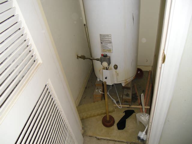

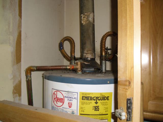

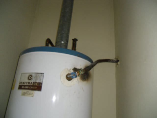

charlieb Posted November 13, 2010 Report Share Posted November 13, 2010 Must be the week. As odd as it sounds, I was in the home of a disabled man this week. He was mid 50s and was disabled by heart problems when he was 25. One water heater was in a bathroom. Painter's tape had been applied to the door, as well as the stairs and furnace closet, to keep the return air from "sucking heat" into the house. The other water heater was in a laundry closet in the kitchen. Not even enough combustion and make up air to that one. The vent was no longer connected to the laundry room water heater. Neither he or his wife seemed to feel very good. I wound up connecting the vent, leaving the makeshift cover off and advising them to so get tested. What treatment, if any, is available for CO poisoning? Click to Enlarge 29.44 KB Click to Enlarge 34.52 KB Click to Enlarge 39.16 KB Click to Enlarge 17.59 KB Click to Enlarge 28.44 KB Click to Enlarge 41.35 KB Link to comment Share on other sites More sharing options...
