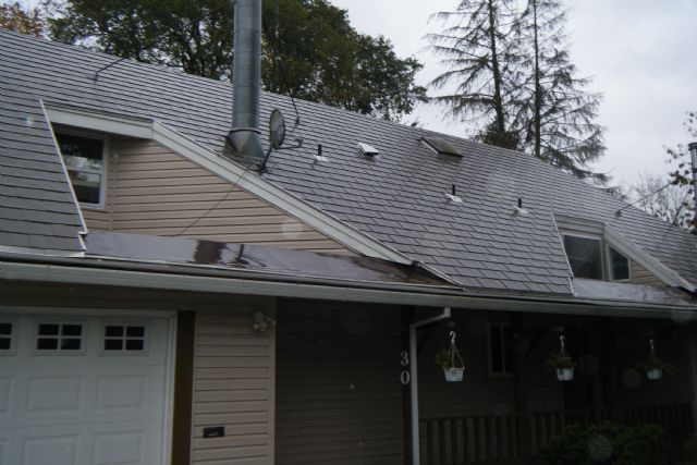

It is an inset, flat roof structure built into a sloped portion of roof; basically the opposite of a dormer.
Click to Enlarge
54.08 KB
Ugly comes to mind!
I have always called that a recessed dormer or an inset dormer.
Posted
:"Ugly detail" would work, but I'd prefer to call it an attempt to confuse contractors and destroy a house. If things aren't done just right, it's a leaker.
There's evidence of leakage at 4 of the 6 recessed dormers, and the owners have spent 6k so far fixing things. There's so many issues with them, I can't figure out what has been "fixed".
Thanks Scott.
