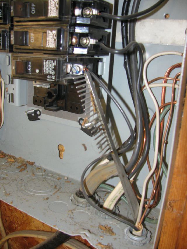

Mark P Posted November 3, 2010 Report Share Posted November 3, 2010 I opened this sub-panel yesterday and found a metal dog comb - really makes me wonder. Click to Enlarge 91.01 KB Link to comment Share on other sites More sharing options...
Marc Posted November 3, 2010 Report Share Posted November 3, 2010 Looks deliberate. Any teens living in the house? Marc Link to comment Share on other sites More sharing options...
Mark P Posted November 3, 2010 Author Report Share Posted November 3, 2010 Looks deliberate. Any teens living in the house? Marc I don't know Marc. I just left it there and wrote it up. It was to close to the lug on the breaker for me to want to reach in a remove it. Link to comment Share on other sites More sharing options...
John Kogel Posted November 3, 2010 Report Share Posted November 3, 2010 Yikes! Sorry for being a smartass, but if the breaker was switched off first, it could be removed safely. But I see why you would not want to tamper with it. It's a crime scene! [] Link to comment Share on other sites More sharing options...

caryseidner Posted November 3, 2010 Report Share Posted November 3, 2010 Holy Shit! This pic makes me glad I always touch the panel with my voltage sniffer first. Link to comment Share on other sites More sharing options...
Mark P Posted November 3, 2010 Author Report Share Posted November 3, 2010 Yikes! Sorry for being a smartass, but if the breaker was switched off first, it could be removed safely. But I see why you would not want to tamper with it. It's a crime scene! [] Funny John & True. I guess if I had any intention of removing the thing I would have thought of a safe way to do it, but I just wanted to put it in the report - kinda cool. Link to comment Share on other sites More sharing options...

Neal Lewis Posted November 3, 2010 Report Share Posted November 3, 2010 Must be the same person who put the grounds and neutrals on the same busbar. Link to comment Share on other sites More sharing options...
fyrmnk Posted November 3, 2010 Report Share Posted November 3, 2010 Yet another reason why bonding the panel enclosure is important, and why I always touch panels with the back of my hand before opening the cover. Link to comment Share on other sites More sharing options...
