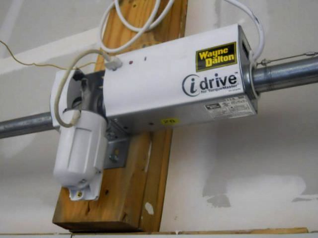

mgbinspect Posted October 14, 2010 Report Share Posted October 14, 2010 Greetings all, Is anyone familiar with this garage overhead door opener: Wayne Dalton idrive for TorqueMaster? I've never seen one. It appears to be direct drive to the spring bar, and the motor is about the size of a fist. It seems mighty enough, but I see no apparent safety reversing features. And, as fragile as the system looks, I'm not excited about testing it for a reversing feature, for fear of damaging the aluminum door or unit. I'm in the field, so I can't upload A picture. This is a two year builder's warranty inspection, so the opener is relatively new. If you have any familiarity with any reversing features, which aren't obvious, kindly inform me. Thanks in advance. Link to comment Share on other sites More sharing options...
Chad Fabry Posted October 14, 2010 Report Share Posted October 14, 2010 It reverses on contact only- no photo sensors Link to comment Share on other sites More sharing options...
Bain Posted October 14, 2010 Report Share Posted October 14, 2010 Safety-reverse photo sensors aren't required. I cribbed the below from their web-site. "Elimination of photo eyes - When using idrive for TorqueMaster models with pinch-resistant doors, photo eyes are not required by federal law. This is because idrive® technology in effect changes the entire door into a reversing mechanism so that no matter what part of the door is obstructed, it will reverse. It is too easy for photo eyes to become misaligned or damaged, thus rendering their safety feature useless. That can be dangerous. " Link to comment Share on other sites More sharing options...
mgbinspect Posted October 14, 2010 Author Report Share Posted October 14, 2010 OK. Thanks guys. I don't even see ANY adjustment screws for a resistance reversing feature. So, I wasn't sure what kind of catastrophe might happen if I attempted to stop it. Link to comment Share on other sites More sharing options...
mgbinspect Posted October 14, 2010 Author Report Share Posted October 14, 2010 By the way, that garage door opener is a cute little rascal - not much to it. Click to Enlarge 30.16 KB The motor is about the size of a soda can. And, unlike most door operators, it takes up very little garage space. I like it! It's surprising they haven't caught on around here. Link to comment Share on other sites More sharing options...

Tom Raymond Posted October 14, 2010 Report Share Posted October 14, 2010 That opener hasn't caught on because it isn't serviceable. The entire door assembly is diposable. Link to comment Share on other sites More sharing options...
