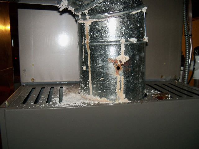

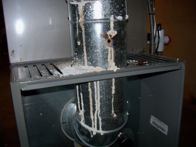

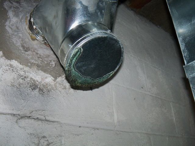

cbass Posted October 6, 2010 Report Posted October 6, 2010 I was at a house today that had masonry chimney, with a clay liner, and a metal liner (flexible metal type). The chimney was capped, and the oil fired furnace was installed about a year ago. The clean out cap at the base of the flue was corroded with a blueish green hard (not wet) substance and there was also a blue stain on the floor below (cap sealed). Also, there was evidence of prior leakage in the form of a white flaky substance at all flue joints and inside the furnace cabinet itself. What is this blue substance? And is this white flaky substance evidence of moisture intrusion or condensation? The flue looked as if it was recently installed (possibly with furnace). Thanks. Click to Enlarge 54.26 KB Click to Enlarge 49.85 KB Click to Enlarge 46.57 KB
Robert Jones Posted October 6, 2010 Report Posted October 6, 2010 Typically when I see that type of issue, it is due to poor ventilation of the flue. The warm air is cooling to fast which is causing condensate.
hausdok Posted October 6, 2010 Report Posted October 6, 2010 Yep, single-walled connector into a masonry flue is allowing flue gases to cool too rapidly and the acid is reacting with the zinc in the galvanizing and causing that mess. Maybe replacing that single-walled connector with a double-walled connector will help; but, if they have one of those corrugated flue liners, I doubt it unless they've sealed the opening between the liner and the sides of the stack so cold air can't surround that liner inside the stack. Maybe the liner isn't properly sized. ONE TEAM - ONE FIGHT!!! Mike
cbass Posted October 6, 2010 Author Report Posted October 6, 2010 Any idea what would cause the blue/green color?
