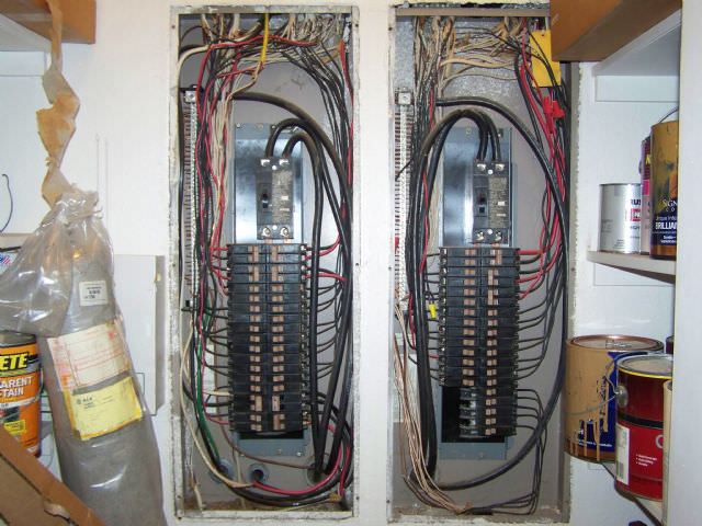

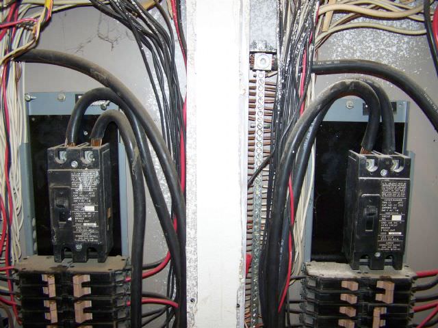

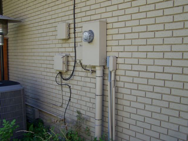

kimball gray Posted October 6, 2010 Author Report Posted October 6, 2010 I guess the question I have for the original poster is whether or not there was a gutter that wasn't sealed near the panels where he could have seen the service conductors feeding the panels. Most of the larger services I see around here have underground laterals because they are in neighborhoods where everyone wanted the power below grade. In upper end neighborhoods with very large homes, I occasionally find multiple panels with a gutter and inside the gutter I find larger cables bringing power to those panels. I have included a couple of pics. I appreciate the replies and input into this forum. Great responses and insight to you all, Thanks Click to Enlarge 55.74 KB Click to Enlarge 72.37 KB Click to Enlarge 72.77 KB
