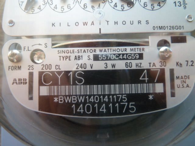

kurt Posted October 4, 2010 Report Posted October 4, 2010 Now we're getting somewhere. I'm getting this as a 200 amp meter. Is that right? Click to Enlarge 44.65 KB
Jim Katen Posted October 4, 2010 Report Posted October 4, 2010 kurt said: Now we're getting somewhere. I'm getting this as a 200 amp meter. Is that right? Yes. You can tell by the 200 CL and the TA 30. If you were to find 2 200-amp panels fed, in parallel, through this meter, it would be a big red flag. Not necessarily wrong, but a red flag because the service drop or the lateral would almost certainly only be intended for a 200-amp service. Someone might have snuck in the 2nd panel without informing the utility. - Jim Katen, Oregon Click to Enlarge 52.88 KB
