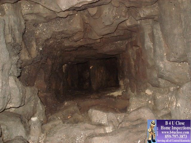

Erby Posted September 17, 2010 Report Share Posted September 17, 2010 Are you sure there's only one flue in your chimney.? Did you get a look at the top of the chimney? The number of spark arrestors visible from the ground is not always indicative of how many flues are in the chimney. Click to Enlarge 84.14 KB Here's an old stone chimney serving two wood burning stove inserts (for kicks). Click to Enlarge 70.6 KB - Link to comment Share on other sites More sharing options...
