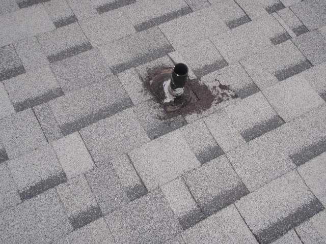

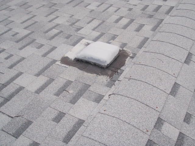

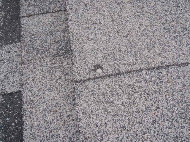

Jerry Lozier Posted September 8, 2010 Report Share Posted September 8, 2010 10 year old roof in high wind area, said it was put on by licensed ? roofer... roofer globbed mastic around roof vents, plumbing penetrations, painted some kind of semi flexible sealer in valleys (said to prevent wind from blowing them off.... roofer who put it on came back out today and said thats the way it is done), upside down field vent (said it came like that from factory that way.... he really did say that), various repaired areas (from wind blowing off??), several areas with missing shingles, lots of exposed nail heads pulling thru. I told them substandard workmanship at minimum, that stuff is not needed if roof is put on correctly the first time (and there are high wind precautions they can make when installing) and no way I would ok the roof, Recommend they take it down to sheathing and start over, by a different roofer, and/or at minimum a different roofer repair areas and give a 10 year cert. Granted it may not affect the life, but I'm not willing to make the call... What say you???? Download Attachment: P9070038.JPG 72.78 KB Click to Enlarge 66 KB Download Attachment: P9070041.JPG 84.18 KB Click to Enlarge 77.95 KB Click to Enlarge 65.63 KB Click to Enlarge 69.36 KB Link to comment Share on other sites More sharing options...
Scottpat Posted September 8, 2010 Report Share Posted September 8, 2010 That is just a crappy roof install! I do not know of any manufacturer that would allow or bless that goop to be painted on a valley like it is shown in the photo. Link to comment Share on other sites More sharing options...

Bain Posted September 8, 2010 Report Share Posted September 8, 2010 I would have said exactly what you did, Jerry. Pull that crap off and try, try again. Link to comment Share on other sites More sharing options...

John Kogel Posted September 9, 2010 Report Share Posted September 9, 2010 roofer who put it on came back out today and said thats the way it is done), upside down field vent (said it came like that from factory that way.... he really did say that) Yeah, but if he'd turned his truck around, it would have been right side up. He just wasn't thinkin that day. [] Link to comment Share on other sites More sharing options...
inspector57 Posted September 9, 2010 Report Share Posted September 9, 2010 roofer who put it on came back out today and said thats the way it is done), upside down field vent (said it came like that from factory that way.... he really did say that) Yeah, but if he'd turned his truck around, it would have been right side up. He just wasn't thinkin that day. [] NO, he jut put it on the wrong side of the ridge. That vent is for the other side of the roof (any body have a three stooges icon?) Link to comment Share on other sites More sharing options...

Tom Raymond Posted September 9, 2010 Report Share Posted September 9, 2010 Jerry, you forgot to mention that there is at least one misaligned course in every pic[:-banghea That roofer is a moron, it's amazing he got that roof done without nailing himself to it. Link to comment Share on other sites More sharing options...
