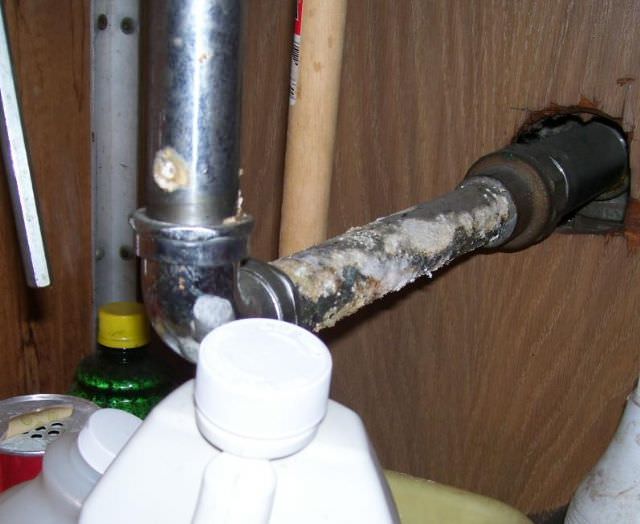

I am inspecting a very large church, 2 schools, rectory and convent at a property this week. I have questions for any Catholics.
What is the room called, where the priest prepares for mass?
There are a pair of sinks in this room. One is small and round and has no trap. The drain doesn't seem to tie into the waste piping of the building and might just dump into the ground. I'm guessing from the extra corrosion that it might be used for dumping leftover wine? Is there a name for this sink?

Yep. Sacristy sink. Google sacristy sink.
Posted
Sacrarium
"In the sacristy you will find the sacrarium -- a special sink with a pipe that bypasses the sewer, unlike an ordinary sink, but instead goes straight into the earth. This sink is made thus to preserve the dignity of sacred things which can no longer be used. For ex., the sacred vessels are rinsed there so that no particle of the consecrated Host or no drop of the Precious Blood will end up in the sewer. The first rinse used to clean Altar linens, old baptismal water, sacred oils, blessed ashes, etc., all these are disposed of in the sacrarium, returning those substances to the earth".
From http://www.fisheaters.com/churchbuilding.html. After finding this, I gotta go put the correct terms for the parts of the church in the report.
