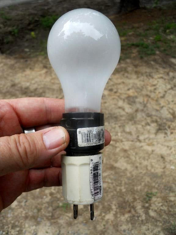

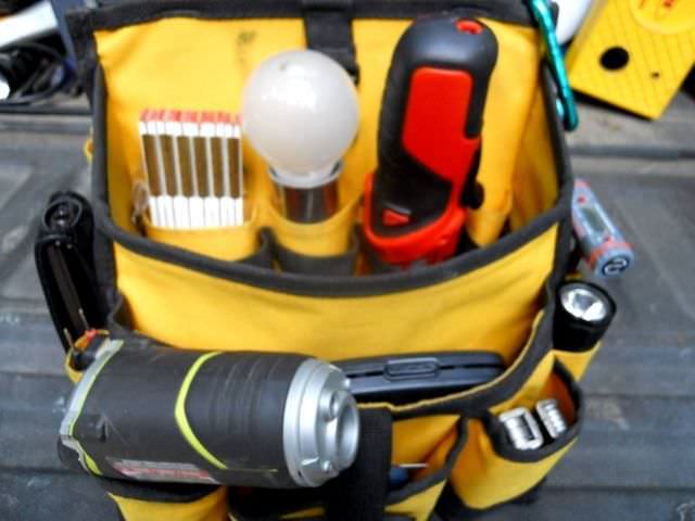

mgbinspect Posted August 13, 2010 Report Share Posted August 13, 2010 Here is a 1 1/2" I. D. metal bathroom sink drain tail piece - available from any hardware Store. Click to Enlarge 60.07 KB But, given a little crimp with a pair of pinch-nose pliers to reduce the O. D. slightly like so... Click to Enlarge 23.14 KB it becomes a handy little lightweight central vacuum hookup tester. Click to Enlarge 33.88 KB The metal completes the circuit between the two contacts and the vacuum fires right up. This tool's been serving me faithfully for about fourteen years. And, my "if all else fails" plug-in work-light, Click to Enlarge 55.64 KB which has come in handy a ton of times, fits right down in it. Click to Enlarge 47.06 KB If you have some similar handy space or effort saving improvised testing tool or equipment. Share the love here... Link to comment Share on other sites More sharing options...

mgbinspect Posted August 13, 2010 Author Report Share Posted August 13, 2010 I just use a coin held at a slight angel to turn on the central vac. I can see myself breaking that bulb in about the first 15 minutes, I'll stick to my Stream light LED, virtually indestructible and runs for hours. That's actually a heavy duty work-light bulb - amazingly tough. Yeah, I have the million candle flashlight and a bunch of other lights, but that work light sure comes in handy in a really dark row house basement when all the ceiling light bulbs are burned out and you need two hands. It makes night day as long as there's an outlet around. Link to comment Share on other sites More sharing options...
