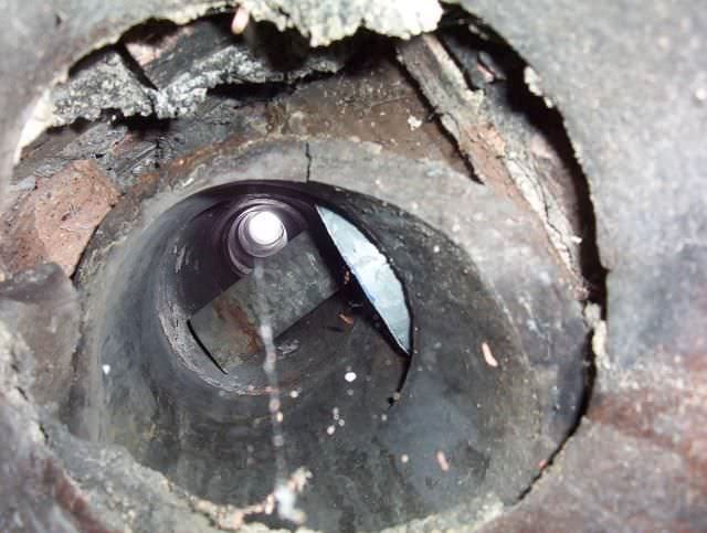

Mike Lamb Posted August 3, 2010 Report Share Posted August 3, 2010 A deranged mind might figure this out pretty quick. I'l post the original shortly. Click to Enlarge 151.09 KB Link to comment Share on other sites More sharing options...

Jim Katen Posted August 4, 2010 Report Share Posted August 4, 2010 The upper third of the image reminds me of bark mulch. I have no idea about the rest. Link to comment Share on other sites More sharing options...
Marc Posted August 4, 2010 Report Share Posted August 4, 2010 The lower part of the image resembles the view into the open end of a pipe. The black line suggests that the 'pipe' is level. Marc Link to comment Share on other sites More sharing options...
kurt Posted August 4, 2010 Report Share Posted August 4, 2010 Undersized plumbing vent with messed up boot. [:-?help] Link to comment Share on other sites More sharing options...

Mike Lamb Posted August 4, 2010 Author Report Share Posted August 4, 2010 It's a jazzed view of a chimney flue from the clean-out. The water heater vent is jammed in there pretty good. This is the photo my client got, not the LSD one. Click to Enlarge 58.5 KB Link to comment Share on other sites More sharing options...

Terence McCann Posted August 5, 2010 Report Share Posted August 5, 2010 What made you look in there Mike? Water heater not venting correctly? Link to comment Share on other sites More sharing options...
Mike Lamb Posted August 5, 2010 Author Report Share Posted August 5, 2010 I always look up the clean-outs with a mirror and a flashlight if I can. This chimney had a newer 80% AFUE furnace and should have gotten a new liner installed anyway. Link to comment Share on other sites More sharing options...
