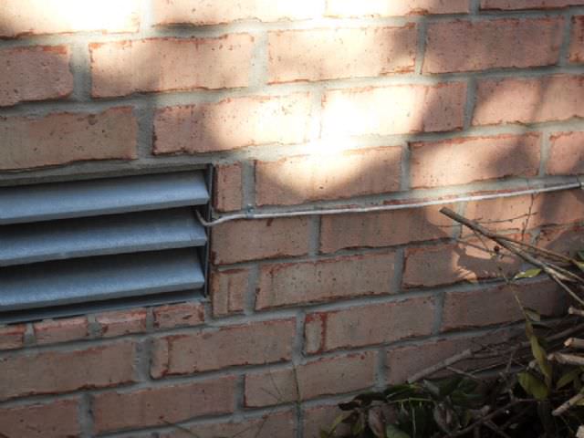

GrantJones Posted July 28, 2010 Report Share Posted July 28, 2010 Hey all, I need a bit of advice. I got a call for an inspection for a property management company about 2-3 months ago. They told me the current owner is out of the country. I didn't worry too much about it and did the inspection as usual. They called me about 2 weeks ago to let me know the owner was coming to town and had a few questions, so expect a call. I got a call Monday and he was concerned about some 'missed' items or things he thought I should've included in the report. He started talking about cables going in through crawlspace vents and said they were electrical cables he thought was a big issue. I took it seriously and met him on site. I get there and found that he's EXTREMELY picky. He was concerned about things like scratches on walls and trim, and a coax cable coming through the floor. Apparently he left in 2006 and there were some changes made while he was gone, and they weren't done to his standards. So now he's asking me to include these on an ammendment to the report. So my ask of you all is twofold. 1. Since my contract is with the property mgt company, what lines should I draw as to providing him with docs or information? I let him know I was concerned and would get back to him, but I may have to deliver any updates to the property management company. 2. Would you have called out the following items, or would you provide an update with them now? -- Long run of phone and coax cable on the side of the house (20 ft, fastened to brick with screws/clips), then goes into a crawlspace vent. It does prevent the vent from fully closing, but I always recommend these stay open year round anyway. There were plants here when I did the initial inspection so it didn't stand out. I see no safety or major issue worth calling out here. He wants it in conduit and not going through the vent. And a single phone wire on other side of house going in through vent. Click to Enlarge 69.49 KB Click to Enlarge 50.42 KB -- Small holes in front porch - 4 of them. These look like they were drilled for a termite treatment then not filled in. They should be filled, but how small of a thing is this? Click to Enlarge 86.49 KB -- Also I didn't get a pic but I did miss something real. In the fireplace, under the charred wood and rack was a gas pipe. They had capped it and covered the gas shutoff with carpet. I plan to just advise him to not use the fireplace for wood burning with that pipe present. He insists that there were gas logs when he left and wants them back. Really I just don't want to get between these folks but I get the feeling I'm being set up to lose. Any advice is appreciated! Thanks! Link to comment Share on other sites More sharing options...

Mark P Posted July 28, 2010 Report Share Posted July 28, 2010 It goes back to what standards of practice you follow and what was agreed too in writing. With that being said, I understand some customers are high maintenance and very picky and dealing with them can be a pain. I find it best to just be straight with them and explain what is and is not included in a inspection. As far as the wires go there is absolutly no reason for them to be run in conduit. So I would tell the guy "they don't need to be in conduit, I never see them in conduit, I've never heard of them being in conduit, but if you want them in conduit have at it as it won't hurt anything. However I will not put it in my report." Regarding them entering the crawlspace vent, I see it pretty often, but don't usually write it up. I would explin it was the cable company and phone company that most likely ran it that way, so they would not have to drill a hole in the house. Agian I would most likely not put it in my report, but if I did I would say something like: "there is a phone wire going through the crawlspace vent that prevents the vent from closing completly. I don't view this as a problem, but if it is a concern for you run the wire some other place" I see gas insert that have been removed and the pipe caped off all the time. It the gas is off at the shutoff valve, I don't see a problem. Of course, you could just tell the company that hired you to deal with the guy as it is their customer, not yours. Link to comment Share on other sites More sharing options...

GrantJones Posted July 28, 2010 Author Report Share Posted July 28, 2010 Thanks guys. I did try explaining these items to him. I told him dealing with coax and phone lines aren't part of the inspection and they were just avoiding drilling a hole, which I didn't see as a big deal. And thanks for confirmation on the conduit. I had seen it a bunch of times, but not usually a run that long, and not usually attached to brick so it did seem a bit odd. Good point, Mike, about getting signoff from the customer directly. I'm sure he did pay for it. Will do that in the future. Time to gently back out of the situation... If anyone else has more ideas, I'll be standing by a few hours on this one. Link to comment Share on other sites More sharing options...
