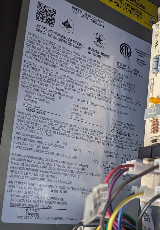

    Home Inspector

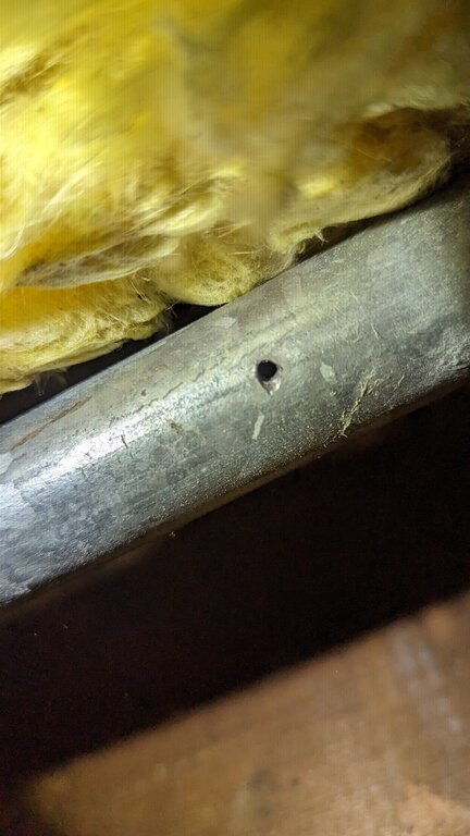

  1. They checked every fitting and still leaked. When all quiet he could hear a slight noise. Cut hole in drywall and ran his fingers down the pipe. Drywall screw thru drywall support bracket into pipe.
  2. "Then just try bonding the grounding terminal to the neutral at the generator - even temporarily as a troubleshooting measure". So, we did that and the fan turned on, but then there was this click click noise? And then the burners lit up. And a little later there was warm air coming out our vents. Color us happy! Thanks again for your help on this. Pulled off the panel holding the outlets on the generator and right on the back side there was a hole to push the jumper in and a screw right next to it to complete the bonding. Piece of cake.

  5. This is how it is advertised by Honda Honda EU1000i - 900 Watt Portable Inverter Generator w/ CO-MINDER™ (CARB) Extension cord connection only. My furnace installer friend has his furnace, same as mine, connected to a standard generator, when our power goes out.
  6. It's portable eu1000i Honda. Should I run a ground wire from it's internal metal frame to house ground rod, or to metal frame of the furnace?
  7. Just read some furnaces don't work with inverter supplied power.
  8. Rheem sent me to an online that was going to cost. Which I didn't try. Been told it's a polarity issue that somehow relates to grounding. Very new 95+ and full of computerish hardware. I have no warranty on this rig, but I think it's not it's fault. Heater installer has large output generator at his house wired into service panel for his same as mine furnace. Mine runs fine on house electric.
  9. Ignition no start. Could be something about generator not grounded. If so, wondering about proper way to ground a small generator to the furnace?
