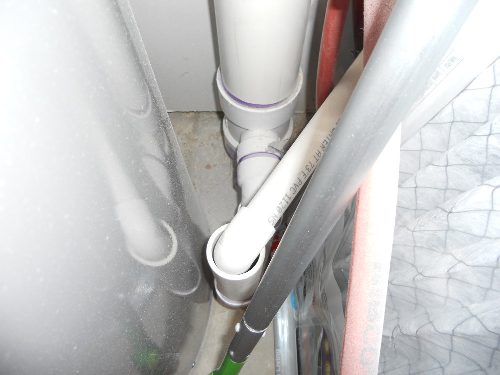

  21. Thanks for the clarification Chad. I initially thought it could potentially back siphon as a result of being too near the main stack.
  22. Had an inspection today with a p trap plumbed directly into the main stack serving the furnace/A/C condensation line. The house was slab on grade built this year. Anything wrong with the configuration? If so, any code cite would be greatly appreciated. Thanks

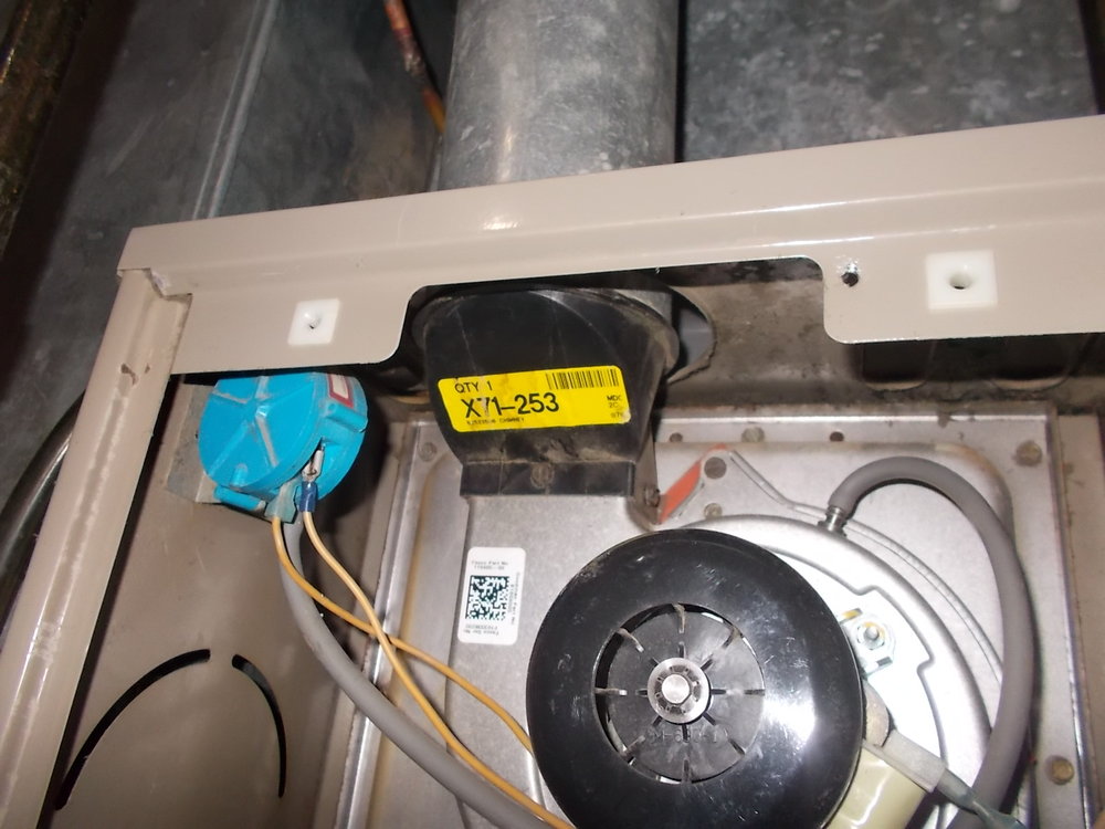

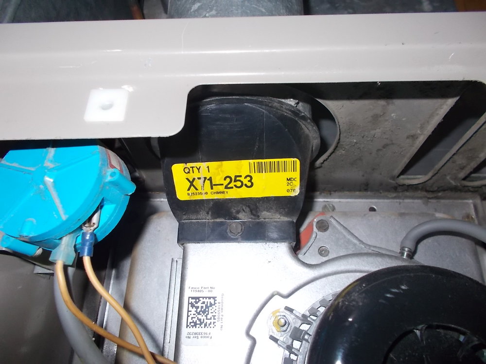

  23. Anybody ever seen this before, and if so how can this be allowed when plastic is considered a combustible material? Plastic vent connector connecting single walled flue and exhaust blower.
  24. Jim, as always you the man!
