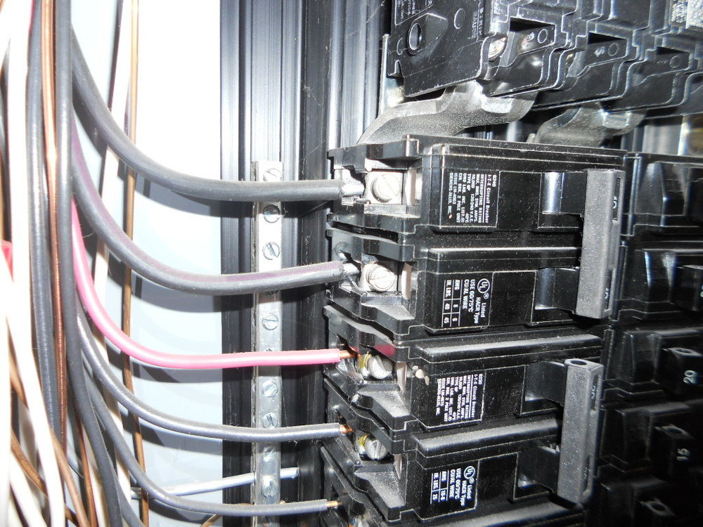

So, I don't see aluminum wiring to often unless its' stranded and typically it's the SEC. At todays inspection solid aluminum #8 was observed at a double pole 40 amp breaker which is serving the electric range. Getting conflicting information about #8 having the capability to serve 40 amp breakers and am wondering if it is adequate and do ya'll make your clients aware of of its' presence regardless of adequacy. It was marked as XHHW #8 and was in a house built in 1986. Top two wires in pictures and picture of the wire jacket is included but apparently not a very good one.

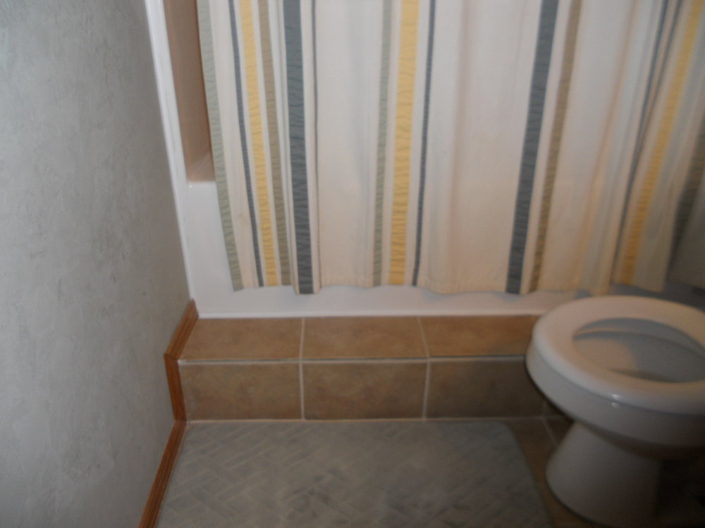

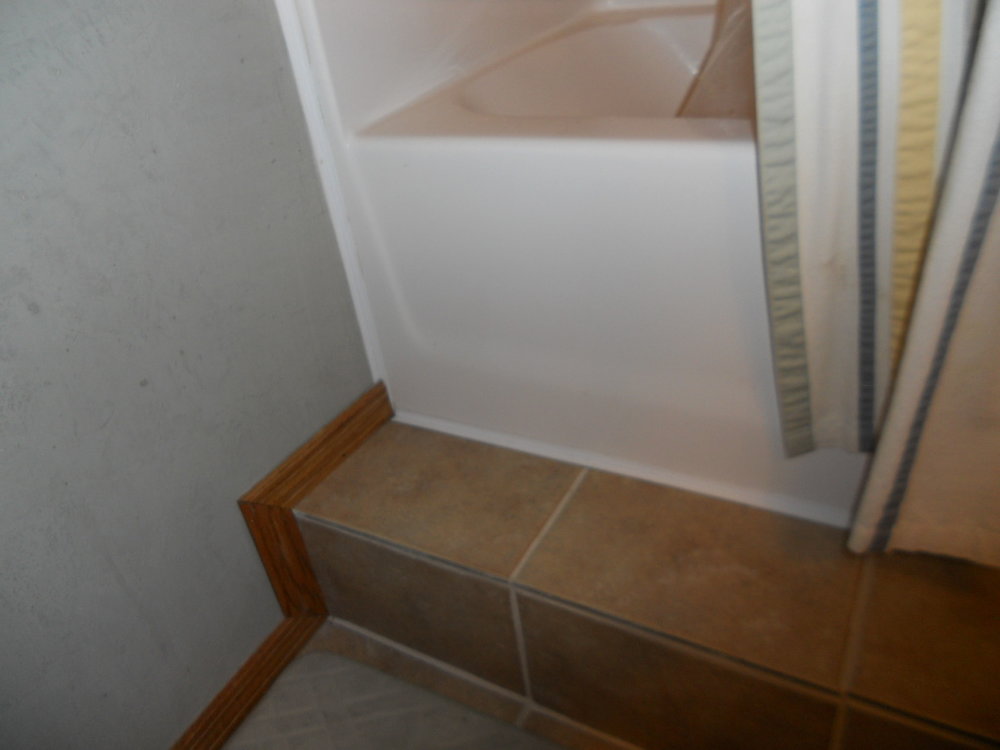

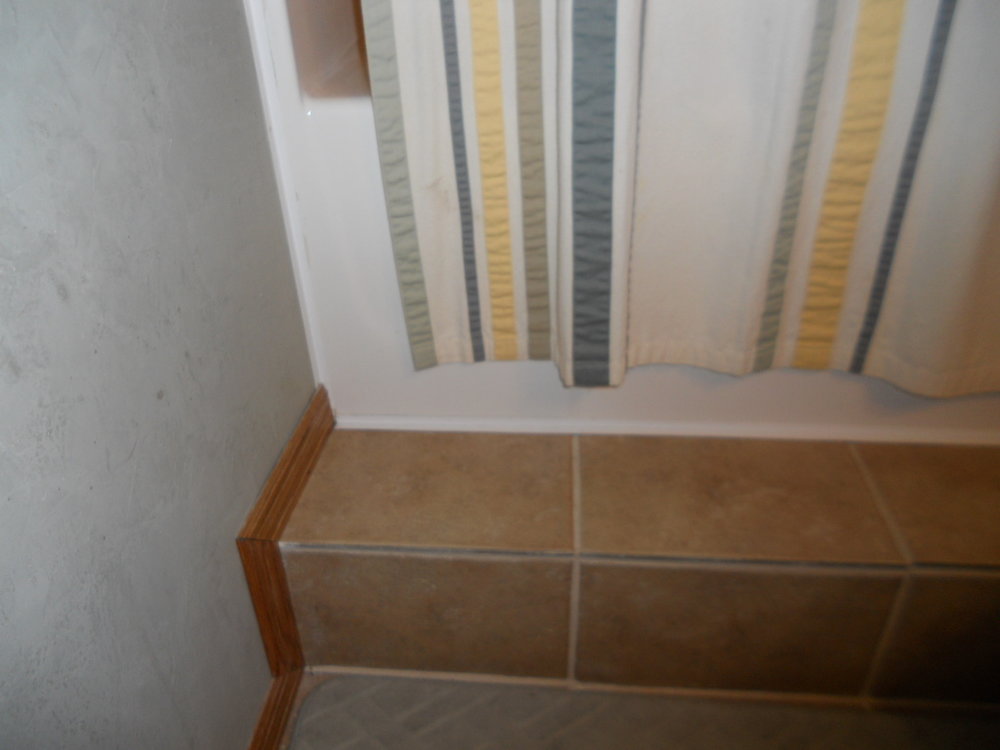

Yes Jim, the step is what I was referring to. For some reason I was under the assumption that steps to showers were prohibited. Checked with the local building inspector and he notified me that they are not prohibited but still require proper step dimensions. If it was in a commercial property and not a home it would be a different story. Still a bad idea in my opinion, bound to be some wipeouts.

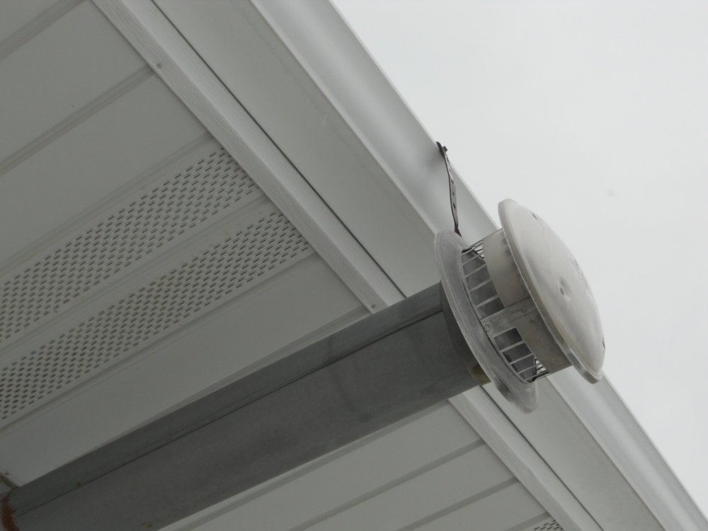

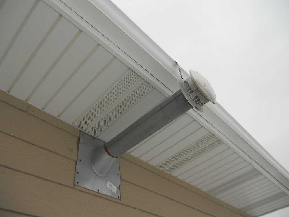

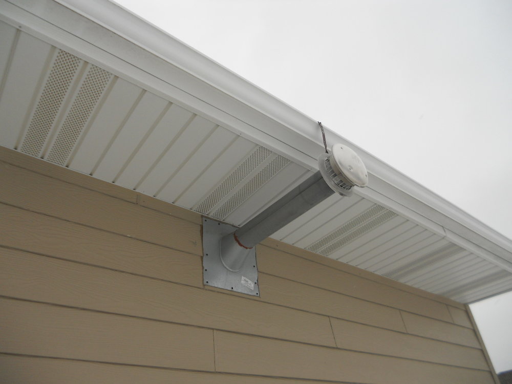

Yep that's what I'm referring to, distance from ventilated soffit. The sidewall direct vent is approved but just needs to clear the ventilated soffit by a certain distance. And that's the question that I have. I do not have the model number or make.
You are looking at a garage heater vent. i haven't seen this condition in awhile and was hoping someone could clarify the clearacne requirement from the soffit. Im reading 2 feet and 4 feet from different sources. I know its typically up to manufacturers recommendations but just need the general rule of thumb. Thanks in advance!
