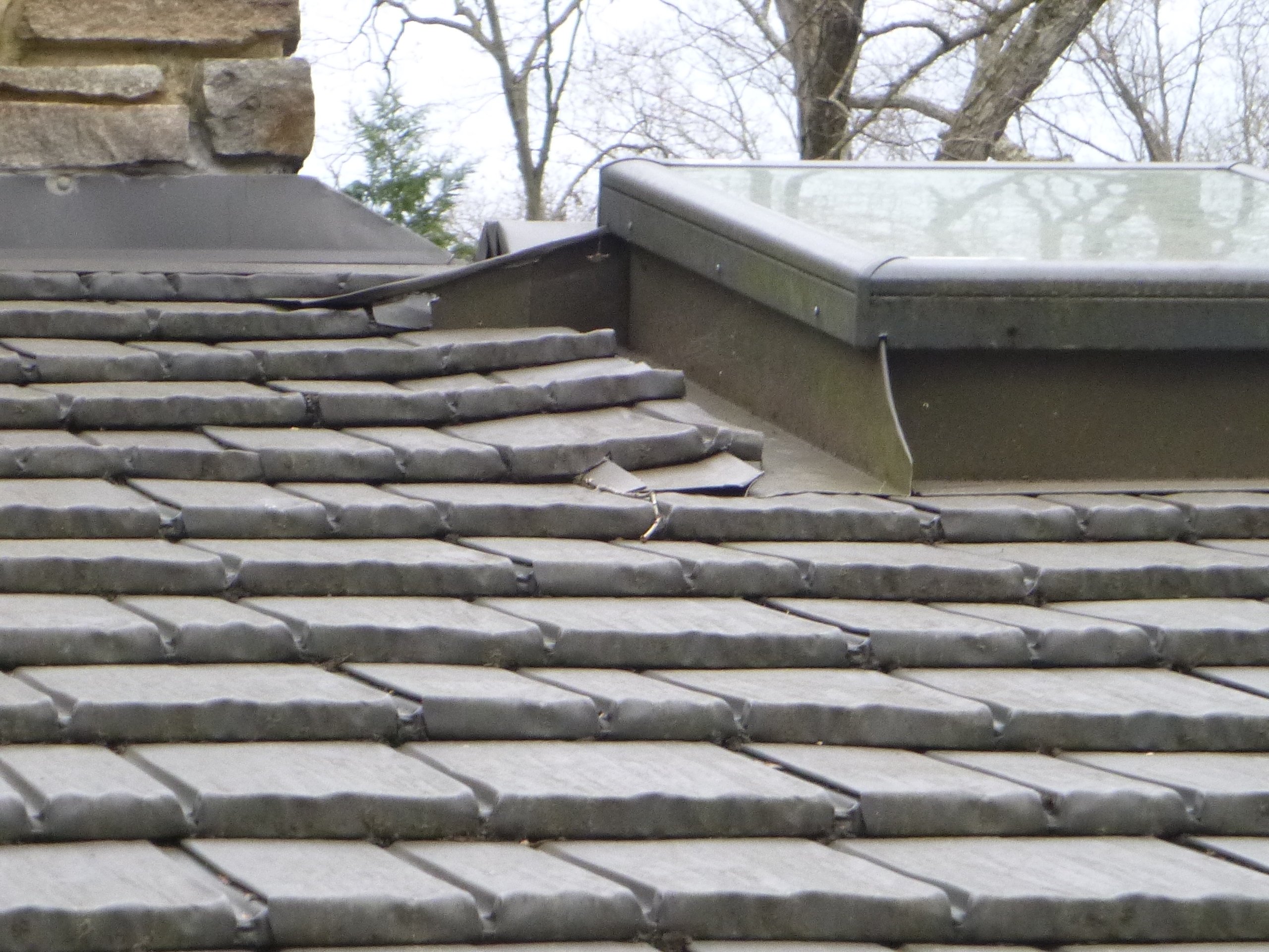

  3. Thanks guys. The response from the shingle manufacturer was that its not the way they list in their sketches it but could still perform fine.
  4. Here's a picture from todays inspection. These are Classic Metal Shingles. Rustic is the model. Other pictures I found on the net have them terminating in a channel next to the skylight. These just overlap a piece of flat metal with a hook it appears. I sent some pictures to the manufacturer too and Im waiting a response. Meanwhile, does this look correct?
