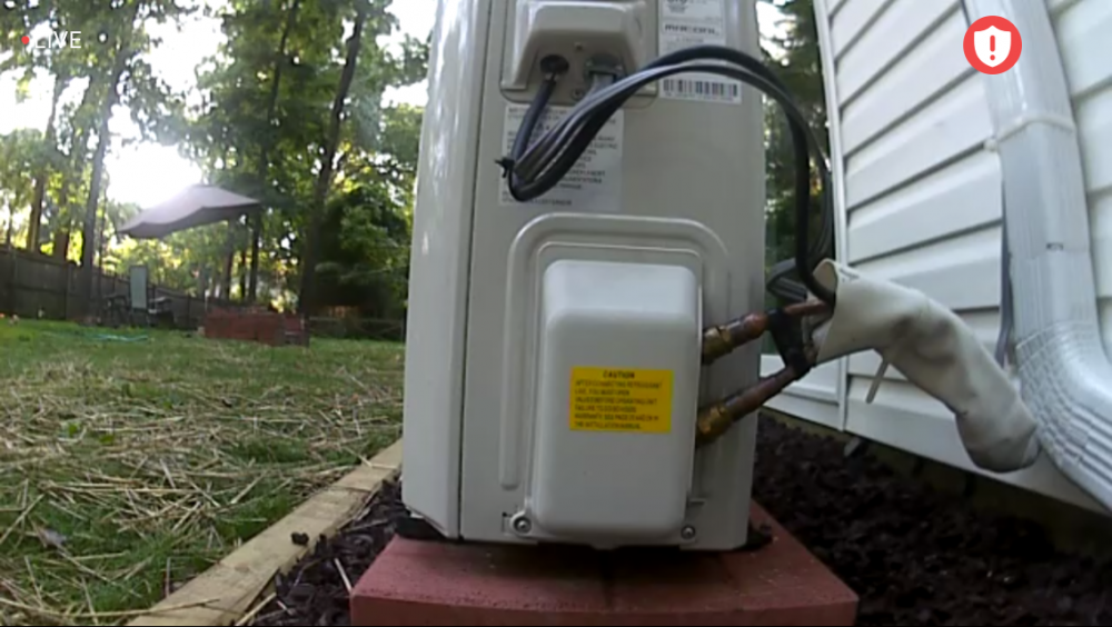

  3. Running now. A little sweat on the line but no ice. Looks ok from here.
  4. Running now. A little sweat on the line but no ice. Looks ok from here.
  5. So far I have not caught any human thieves in Arlo. But I’ve caught deer, squirrel, raccoon, opossum , fox, feral cat, spiders, birds and bats.
  6. I sure hope the performance holds. Otherwise, it’s back to leak hunting. I’ve got my Arlo wireless security cam positioned to remotely monitor the refrigerant lines to see if they freeze up. There’s an orange ribbon tied to the grill which I can see fluttering on the cam when the unit is running. Obviously, it’s not running in this picture.

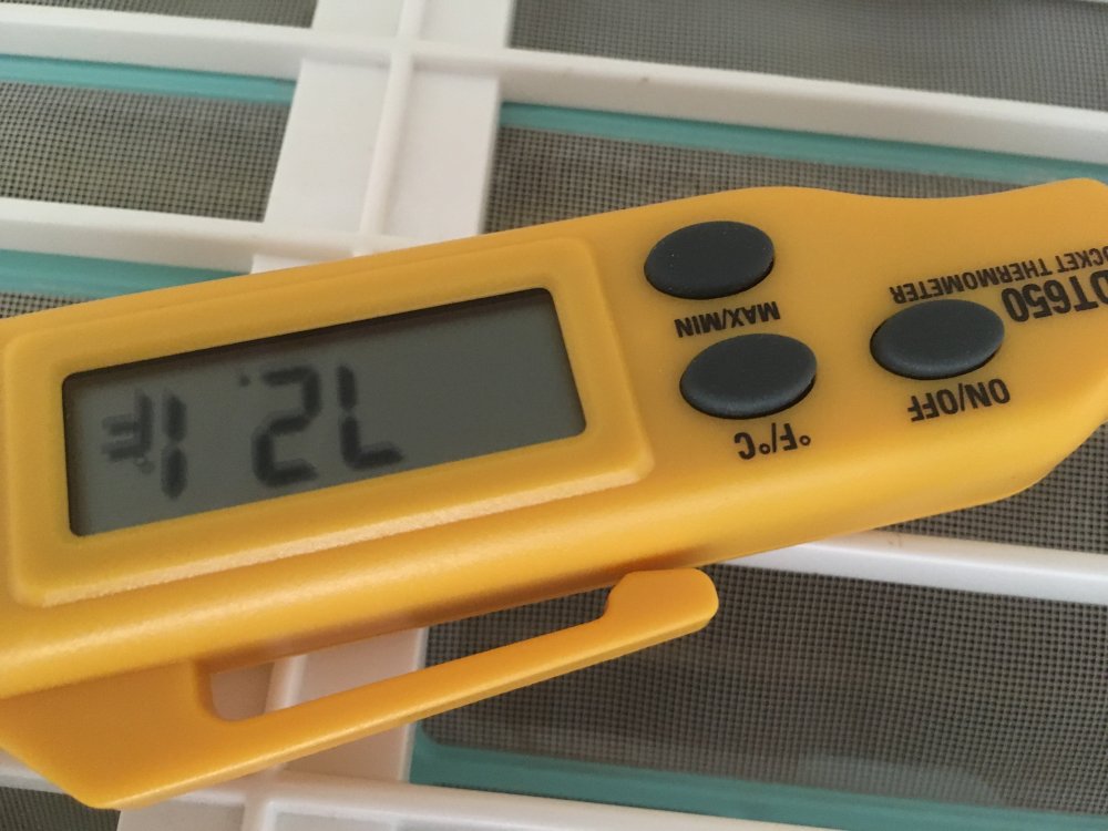

  8. 18 degree difference with this probe type thermometer.

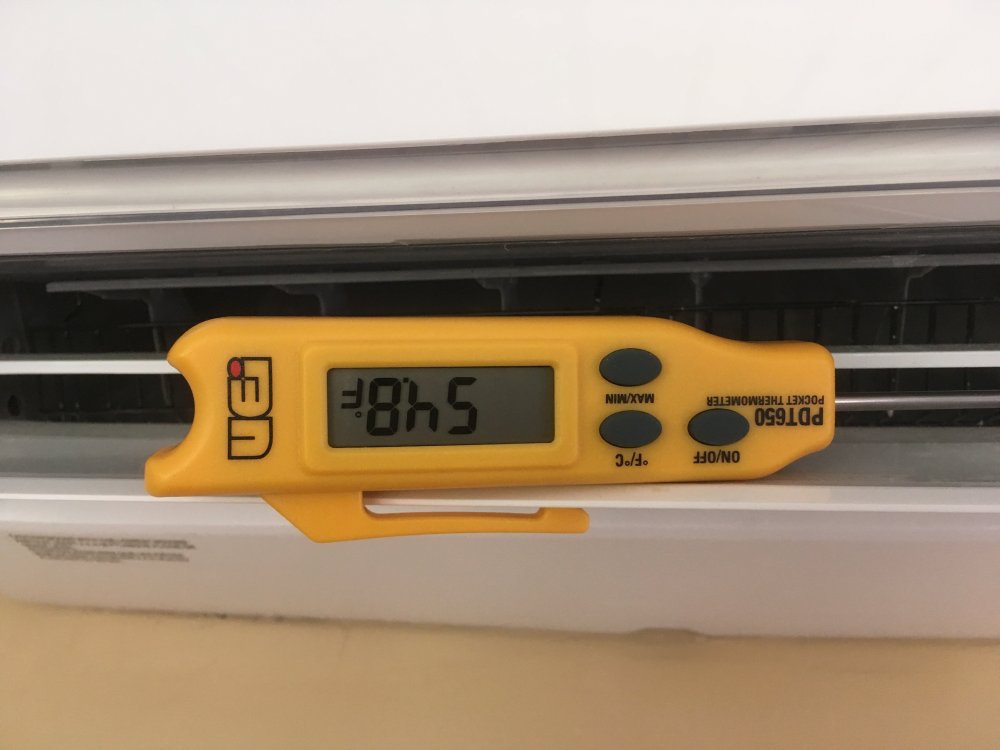

  10. I will get a proper tool for measuring air temp and do it again. But once more, the evap core is not visible through the front louvre. That 45 degree measurement is from the plastic blower wheel.

  12. I know it’s surface temp on that tool. Although, the fireplace remote has a room temp display on it. It was reading 81 degrees 4’ off the floor. So the temp 8’ up the wall above the evap core can’t be lower than that. I can’t see the evap coil by looking through the louvre on the front of the unit. That 45 degree reading was off the edge of the blower wheel which is plastic. So I doubt the air temp at that point is much higher. Im not convinced that I’m substantially off the mark with those readings. But I could be wrong.

  14. Jim, I think the thermometer is far from optimal, but not worthless. Marc, that is the widest spread I’ve ever gotten with that less than optimal thermometer.
  15. Temp drop across the evap after 5 mins of running. 80 in, 45 out
