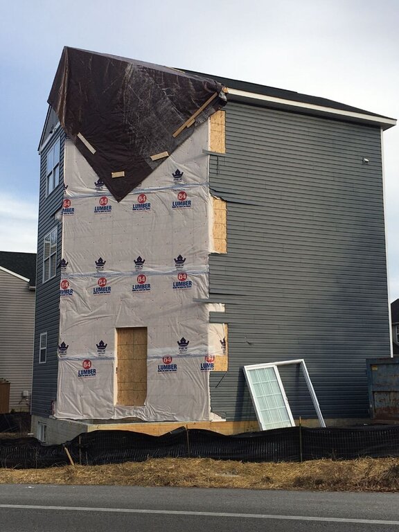

I suppose it’s possible they knew they had a problem earlier in the initial construction and decided to continue and file for an easement. Then the easement was denied. I’ll get the property address and run the permit info and see what it says.
I know right. You would think the AHJ would have threw the flag on the footing inspection. Maybe even the grading permit. I figured these pictures might be good for a few laughs at any training event. Help yourself. Grab the Google Earth angles to.
I thought you guys might humor this. This house is a couple miles from me and sat unoccupied following its construction several years ago. I always assumed it was a setback problem because it was oddly too close to the roadway. What I saw today when I drove by confirmed my belief. If you want to see the setting from Google Earth, the coordinates are 39.094444 N 76.576687 W The Google Earth street view still shows it before the chopped it off.
