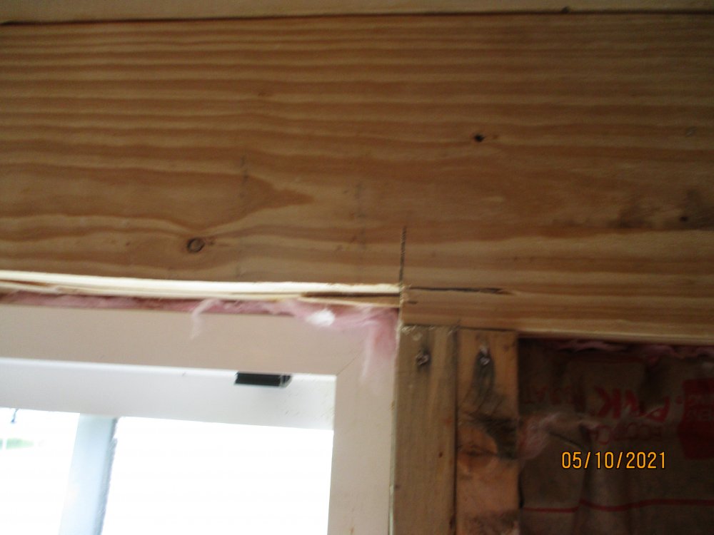

  5. Jim, Not a pre-drywall inspection just a regular inspection on a brand new home. And thank you for the reminder that a header suffers the same limitations as beams do. I was overthink things as I do on occasion. Appreciate the help you guys
  6. Appreciate the info Marc. It was wider than 4' as it was above the sliding glass doors but there's just a single story above
  7. Good afternoon ladies and gents. I am writing a report for a new build I inspected this afternoon and ran into a header that I am assuming (yes I know what they say about assuming) was notched to fit in a sliding glass door. I am drawing a complete blank on coming up with reasoning why they shouldn't have done this. I don't recall a code cite for headers offhand and I'm having issues finding much information online. I can't recall seeing a header notched before. Plenty of joists, beams and the like. At the worst they've poorly notched out approximately 2" from the doubled 2x8's. Other than being a hack job can you learned gentlemen steer me in the right direction?
