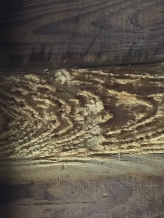

  14. Ha ha. I can probably get one from the hospital. Thanks much!!
  15. It's a big layer of sawdust on top of the water. No dissolution.
  16. It is smooth like talc. I'm not brave enough to taste it. My plan is to get a shop vac out there and clean up the boards to see if there is a hole. I did brush a section, and no hole. It was LOT of sawdust, however. So, I think I will try a shop vac. Thanks again.
  17. Well, whatever it is, it is definitely weird. There is a LOT of dust. And it seems to be spreading in real time (days, not years). I'm going to try to spray it with Timbor because it is cheap and non-toxic. The dust could be obscuring the holes. Not sure what else to do except spray it with fungicide next.
  18. Whatever it is, it's very strange. There is a good 2cm of dust on there. It seems to come back after wiping it, and that board has a hollow sound. But jamming a screwdriver in it doesn't break the wood. It's very good wood, that is for certain.
  19. I did. The wood is solid, but has a LOT of sawdust on the underside. So much that it is difficult to sweep it down to the wood. I don't see any bore holes from insects, but there is a lot of dust there. It is as if someone is sneaking in and sanding the underside of the wood. It is just part of one plank.
  20. Thank you so much!! For some reason, the system did not notify me of a response. It is in an unconditioned garage, 90 years old, hardwood. The surface has been exposed since the garage was constructed. It's damp in there, and firewood was brought in and left nearby. 1 plank infected. I can sweep off the dust and have a look to see whether there are holes. I was thinking powder beetle, but haven't removed the dust.
  21. Can anyone identify what is causing this? Fortunately, it seems to be contained, and mostly on the underside of this board. The indentations in the dust are from my thumb.
